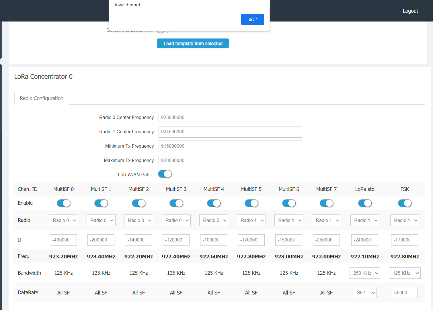

Struggling with connecting devices that operate on AS290-923 and discover in WisDM there is no option for AS920-923 (“AS1”) for TTN, the included AS923-1, AS923-2, AS923-3 and AS923-4 frequencies does not match with the required frequency:
AS920-923 (“AS1”)
Used in Japan, Malaysia, Singapore
Uplink:
- 923.2 - SF7BW125 to SF12BW125
- 923.4 - SF7BW125 to SF12BW125
- 922.2 - SF7BW125 to SF12BW125
- 922.4 - SF7BW125 to SF12BW125
- 922.6 - SF7BW125 to SF12BW125
- 922.8 - SF7BW125 to SF12BW125
- 923.0 - SF7BW125 to SF12BW125
- 922.0 - SF7BW125 to SF12BW125
- 922.1 - SF7BW250
- 921.8 - FSK
Downlink:
- Uplink channels 1-10 (RX1)
- 923.2 - SF10BW125 (RX2)
And when I try to set the frequency by hand, when I click Save & Apply, it said the input is invalid
Any ideas?
