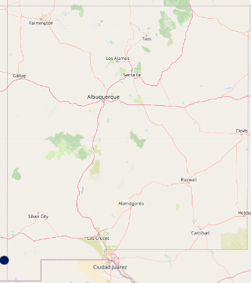

a map of every LoRaWAN server in NM:
Screenshot 2025-06-13 181106
the servers are the black dots. I live smack dabbledy dog in the middle. You could use an 1868 map with the same effect.
