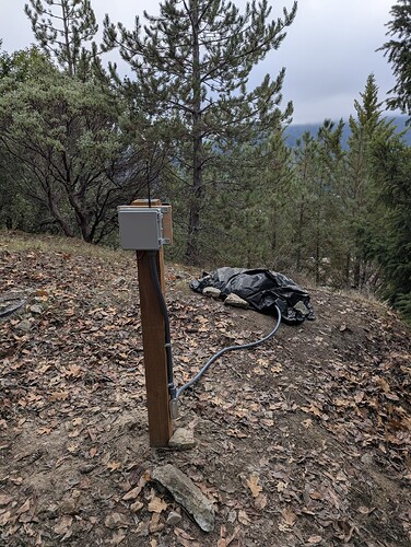

Hello, I have built a monitor for a remote water holding tank. My system has been deployed for 5 days now and it’s working really well it would seem. Having said that, tt’s been raining and overcast (see picture) every day until today, when I got a few hours of sun. They system is running off of an 1800mAh LiPo battery and I have a 5v solar panel facing south with out much obstruction. My battery has been very slowly dropping and today it dropped below 75%. It seems to me that the solar panel has been helping considering I still have between 50% - 75% after 5 days of use. The radio is only sending updates 3 - 5x/day, although I’ve got some code cleanup to which I think will drop battery usage.
Picture for interest:

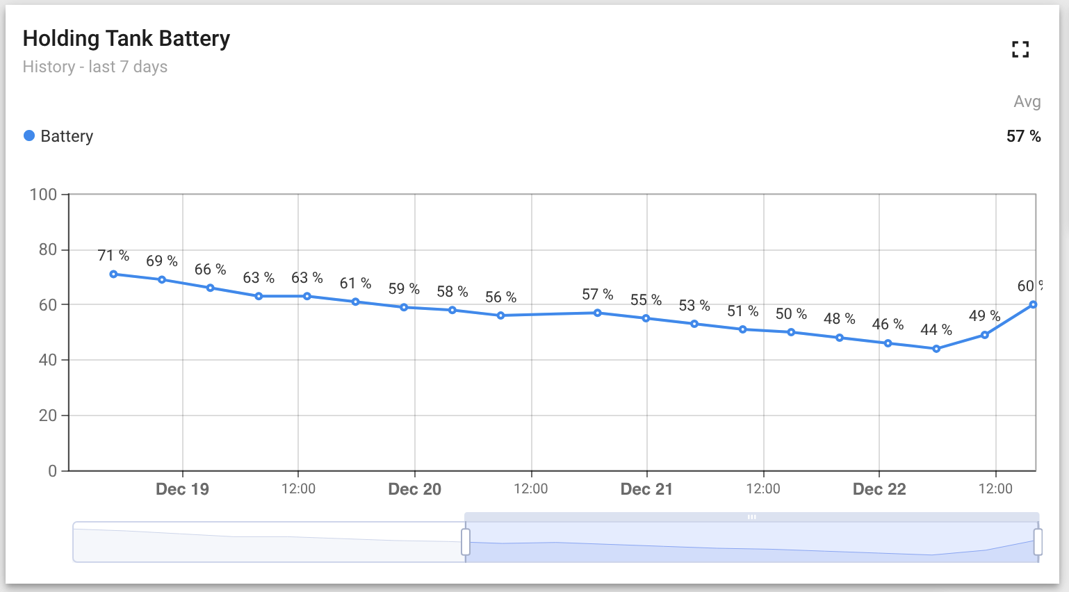

I decided not to add another panel and just see how long I could run. The system has been running since the 13th and we’ve had very little sun and then about a week of rain. Today we got a few hours of sun and the battery is recovering well:
I implemented some code to send battery percentage on the 18th, so I don’t have info prior, but man, I’m impressed with how little power this system uses!
