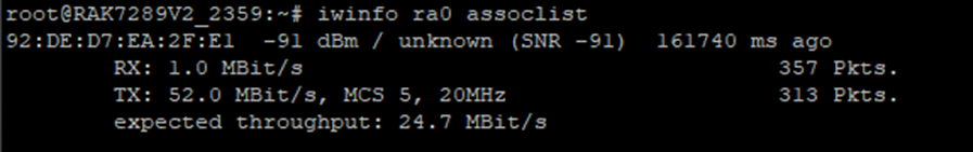

After the execution you can confirm with:
iwinfo ra0 assoclist
You should see output like this:
