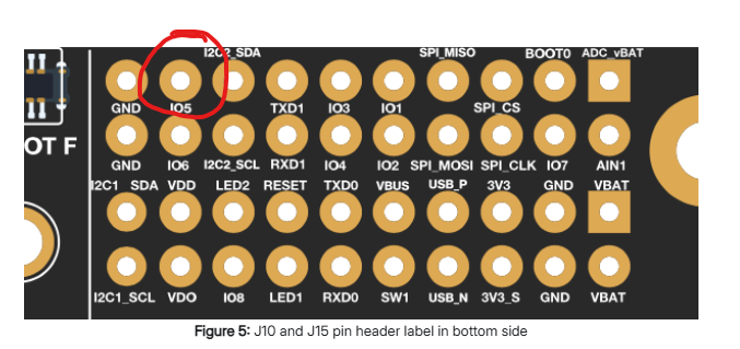

So I decided to try a 3.3v vibra motor. Wired it up with a pn2222 to IO5:
and set the GPIO to 9 (Again, is this correct?!) but again no dice.
