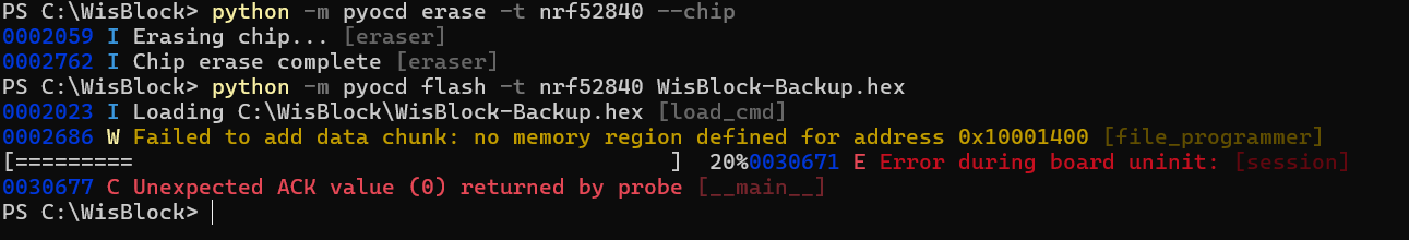

Here is what I get when I try those commands:
This is with the RAK powered by a seperate USB power source and the 3v rail not plugged in on the RAK side.
Actually got a little further this time.
It appears to erase the chip but when I attempt the flash, it fails at 20%.
That sounds to me like a bad connection between the DAPlink and the device. I am getting sometimes errors while flashing a firmware with DAPlink and pyocd, not sure why. That’s why I prefer JLink. It works more stable.
