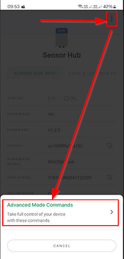

When connected to the SensorHub via BLE, can you go Advanced Settings ==> Console ==> and send ATR to the device. This will perform a factory reset of the device.

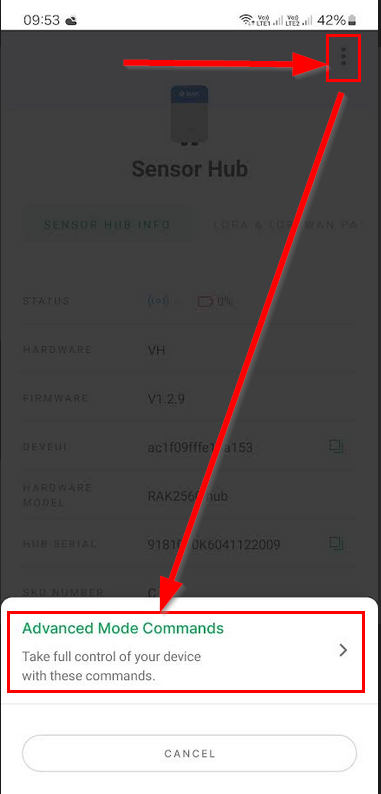

(1) Tap on the 3 dots in the upper right corner, it opens “Advanced Mode Commands”. Click on “Advanced Mode Commands”

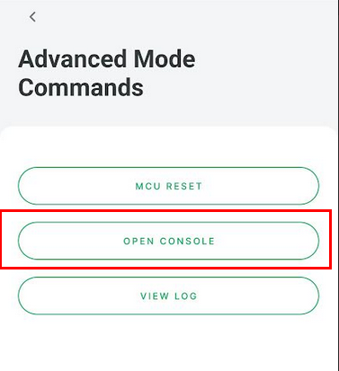

(2) In the “Advanced Mode Commands” Menu, select “Open Console”

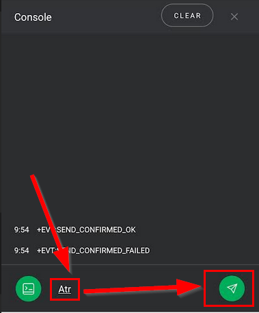

(3) In the “Console”, enter ATR, then send it to the device.
The device will reboot after that command.
Let me know if this changes anything.
After using the ATR command I am now able to successfully configure the LoRa parameters. Thanks for the advice!
