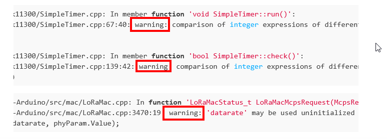

But when I build with IS_LORA flag it error:
.pio/libdeps/rak4631_lorawan/SX126x-Arduino/src/boards/mcu/rak11300/SimpleTimer.cpp: In member function 'void SimpleTimer::run()':
.pio/libdeps/rak4631_lorawan/SX126x-Arduino/src/boards/mcu/rak11300/SimpleTimer.cpp:67:40: warning: comparison of integer expressions of different signedness: 'long unsigned int' and 'volatile long int' [-Wsign-compare]
   67 |    if (current_millis - prev_millis[i] >= delays[i])
.pio/libdeps/rak4631_lorawan/SX126x-Arduino/src/boards/mcu/rak11300/SimpleTimer.cpp: In member function 'bool SimpleTimer::check()':
.pio/libdeps/rak4631_lorawan/SX126x-Arduino/src/boards/mcu/rak11300/SimpleTimer.cpp:139:42: warning: comparison of integer expressions of different signedness: 'long unsigned int' and 'volatile long int' [-Wsign-compare]
  139 |    if ((current_millis - prev_millis[i]) >= delays[i])
.pio/libdeps/rak4631_lorawan/SX126x-Arduino/src/mac/LoRaMac.cpp: In function 'LoRaMacStatus_t LoRaMacMcpsRequest(McpsReq_t*)':
.pio/libdeps/rak4631_lorawan/SX126x-Arduino/src/mac/LoRaMac.cpp:3470:19: warning: 'datarate' may be used uninitialized in this function [-Wmaybe-uninitialized]
 3470 |  datarate = T_MAX((uint8_t)datarate, phyParam.Value);
main error:

should already throw a compilation error. the correct syntax is #ifndef IS_LORA
I see only warnings in the compilation output, no errors:
A warning does not stop the compilation, your final error is still linked to the #defines.
Other than that, I can’t tell you why it doesn’t work.
