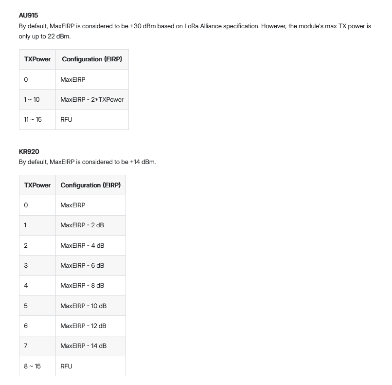

Welcome to the forum @Ch.Yoon
TX power 7 has different meaning, depending on the LoRaWAN region.
AU915 definition says TX 0 = 30 dBm (but the module can only support 22dBm)
TX 7 means 30 - (2 x TXP) == 16 dBm
KR920 definistion says TX 0 = 16 dBm
TX 7 means 0 dBm
These definitions are from the LoRa Allianceⓒ document LoRaWAN® Regional Parameters RP002-1.0.4
