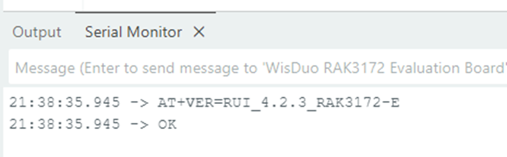

My problem now is programming the RAK3272S. I use the Arduino IDE and an ESP-01 adapter connected to my computer (Windows 11). AT commands seem to be working:
