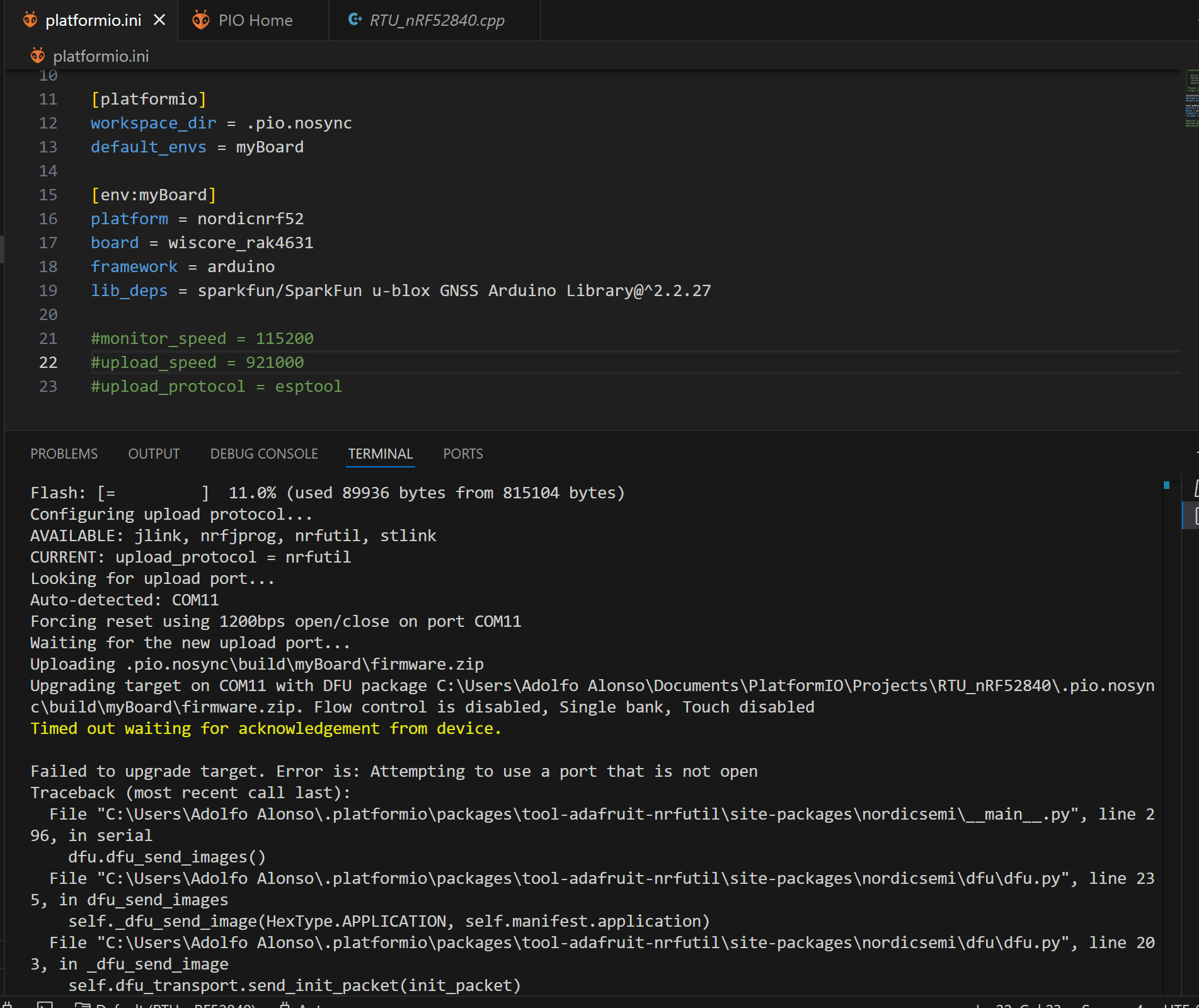

please help me to upload code to my RAK4630 using a esp-prog in PlaformIO.
I get the following error:
I have searched many forums with no luck.

ESP-PROG is for Espressif MCU’s.
It doesn’t work with Nordic MCU’s.
If you want to upload through the USB of the RAK4630, you have to use adafruit-nrfutil
Hello,
What I want to do is upload firmware to the RAK4631 through the J21 pin header of the RAK19011.
This is because the RAK has been installed inside a small enclosure and can’t change the RAK19016 for the RAK19012 to use USB.
The RAK4631 firmware can only be updated over the USB. It is not possible to do it over the other UARTs. The bootloader does not support that.
Only other option is to update over BLE, but that has some risks.
