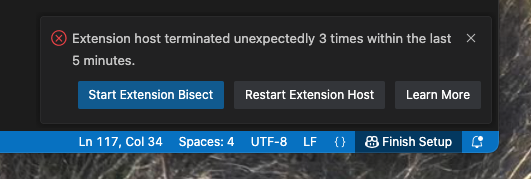

I’ve been working on trying to get a consistent picture.
When I plug the RAK device into the USB port, I can see it appear in the USB Device Tree (under AboutThis Mac/SystemReport/). It also appears in “ls /dev/cu*”.
I needed to restart the Arduino CE extension in VScode to get the Port to show and be selectable for the lower right hand corner. I made sure that this port was also selected for the Serial Monitor and tried to upload.
There were three single line messages on the the VScode OUTPUT tab that flashed and disappeared, and I got this pop up:
Screenshot 2025-07-14 at 2.01.14 pm
Then all the Arduino Extension functionality disappears. The Rak4631 Serial COM entry still appears in the USB Device Tree report (even when I regenerate that report) but it has disappeared from /dev/cu*
I’ll let you know if I find anything more, but I’m suspecting the USB drivers

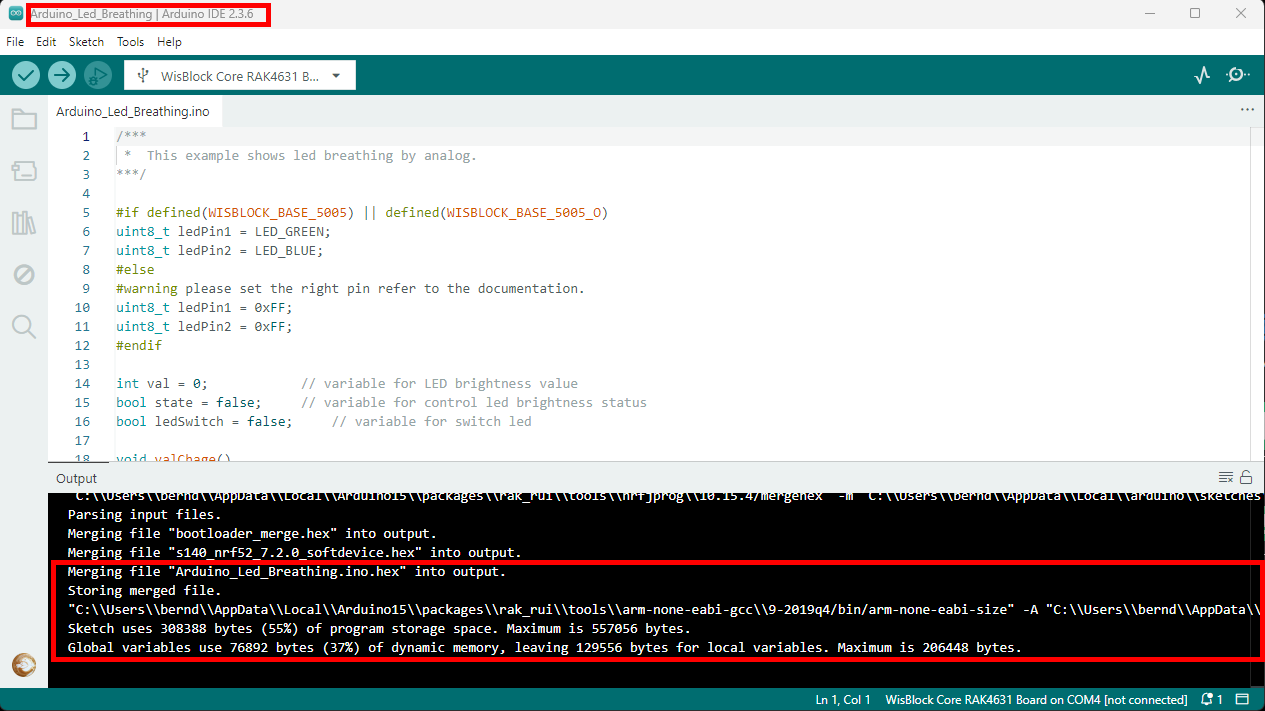

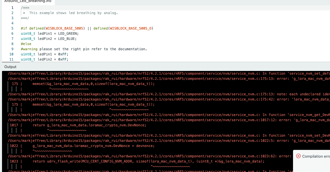

None of the Arduino RUI3 examples for the RAK4631 are currently building for me. Here’s a snapshot from Arduino_Led_Breathing.ino
This DOES build under VScode. It’s the loading I’m struggling with.
The examples are compiling for me. It throws a lot of warnings, but it compiles.
Maybe your BSP installation in ArduinoIDE is messed up.
Try to uninstall it and delete anything in the staging folder of Arduino to make sure it uploads another copy.
But again, this is Windows. I can’t test on MacOS.
I reinstalled the RUI nRF Boards BSP and that certainly fixed the Arduino IDE build errors. Thanks.
