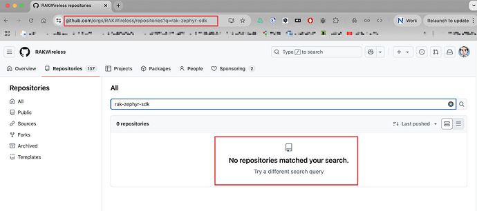

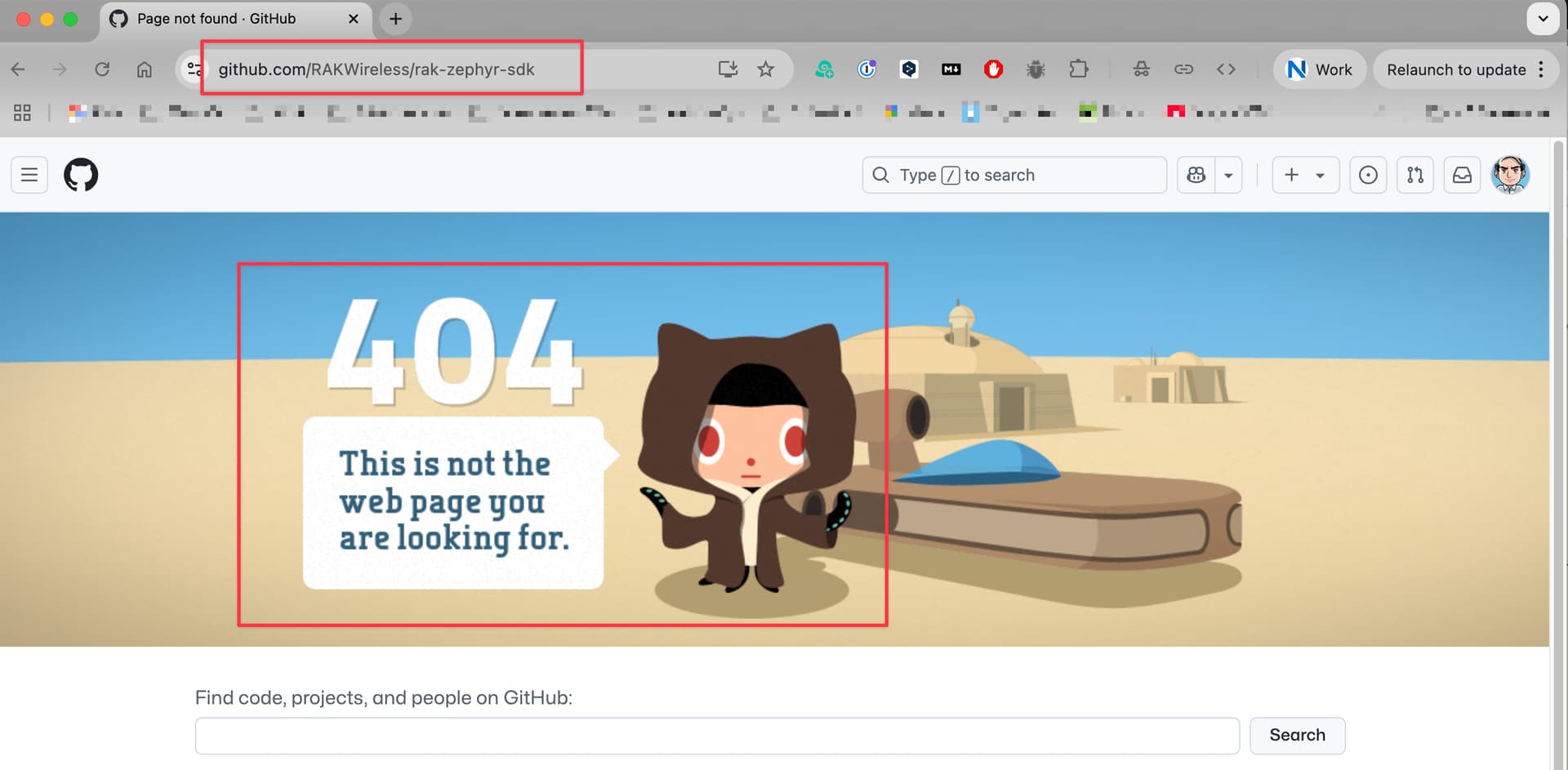

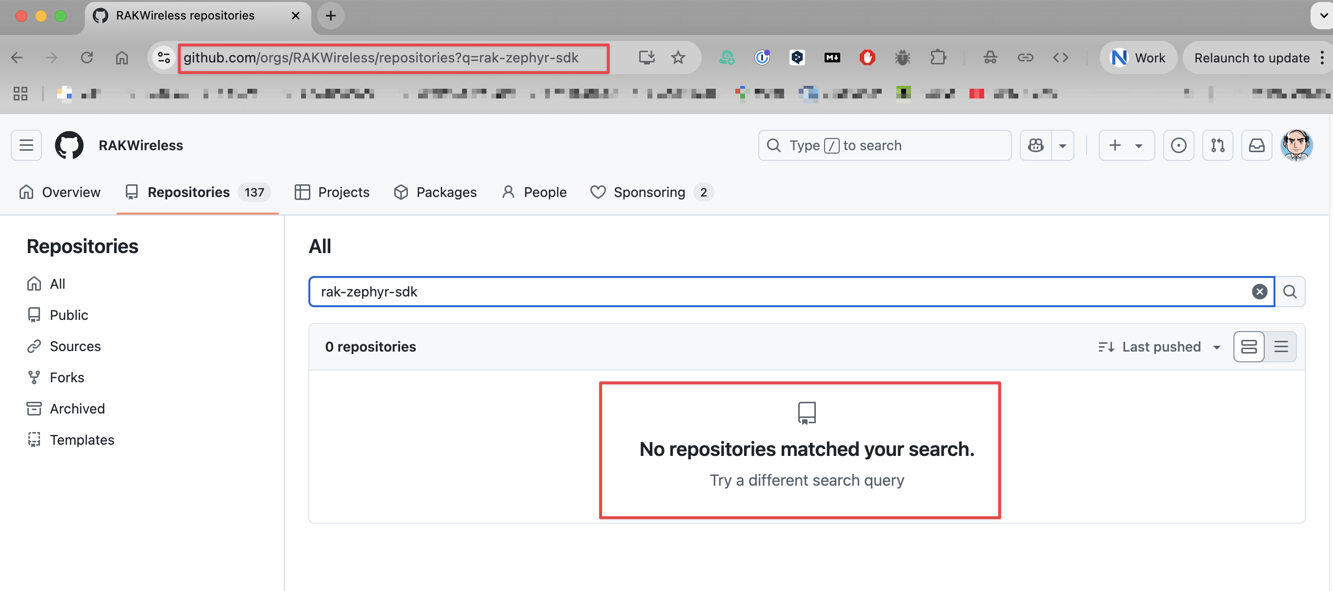

We are still testing Zephyr. Your link is broken, but there is another project that can be used as a good starting point: https://github.com/srcnert/rak-zephyr-app

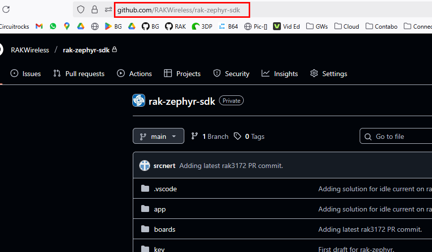

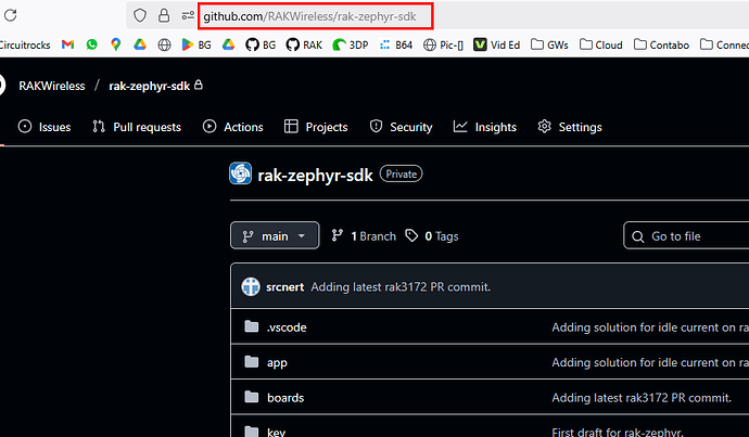

Not sure why you think the link is broken.
It works for me and the repo is not set to private.
I will check with repo owner tomorrow.

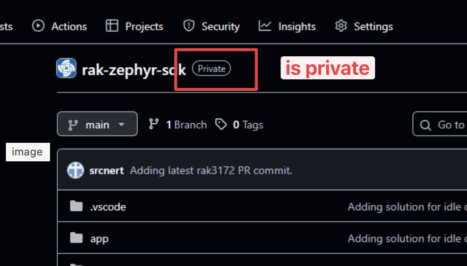

IMO it’s private or has a restricted access:
Yes, it’s private!
Sorry, didn’t see that. Will ask the owner to make it public.
