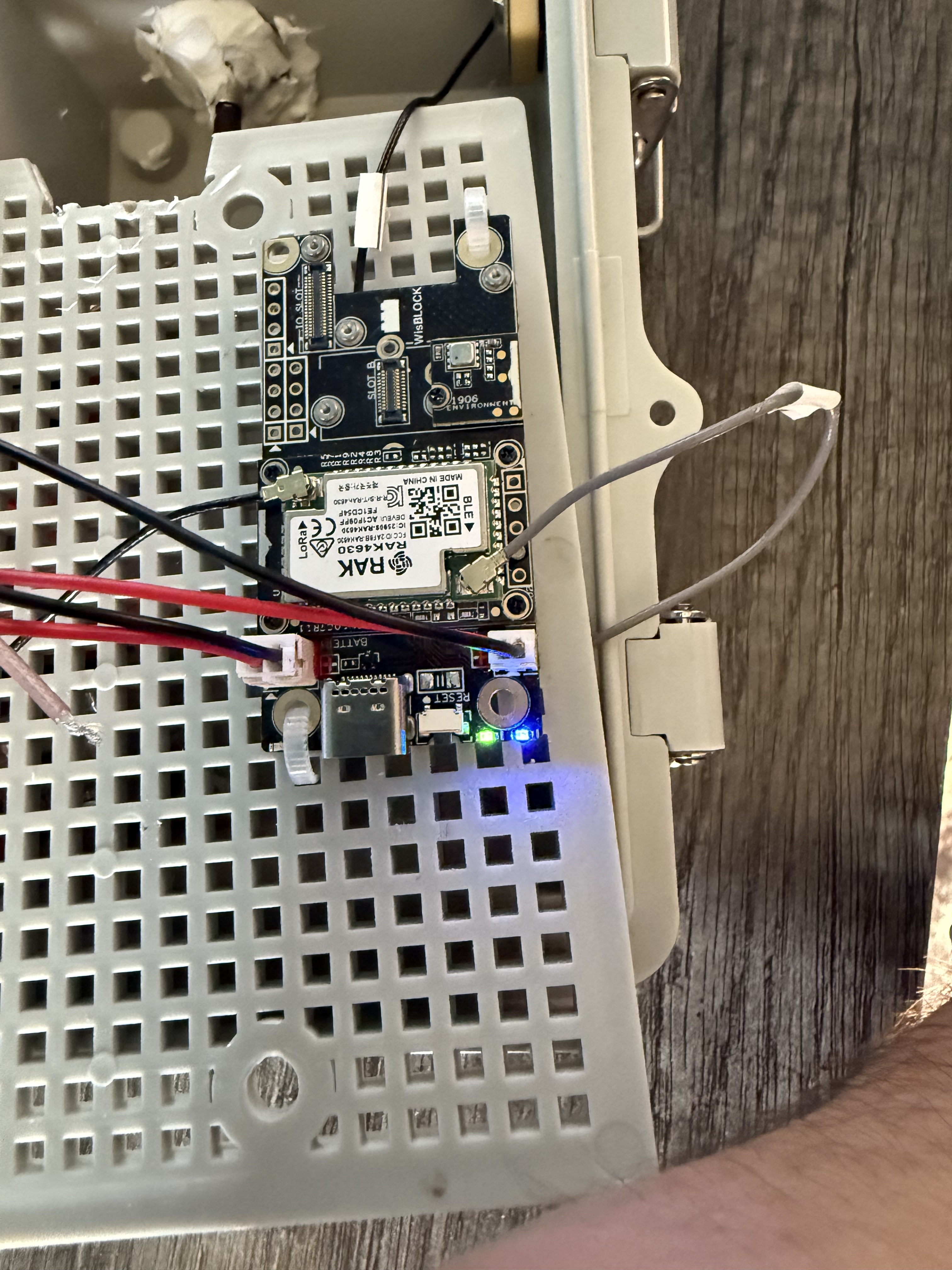

What am I doing wrong? This node works perfectly when on battery power. When I put it into the sun light to use the solar power a couple mins later it disconnects and does not boot back up until I hit the reset button.

Please show how the solar panel is connected to the Base Board.
Good afternoon @beegee
I am using a Fellden Micro Solar Panel 5V 200mA Photovoltaic Solar Cells. I purchased them off of Amazon. The firmware is 2.6.4 the newest stable firmware available. The battery and the solar panel are hooked up straight to the proper JST connector on the board. I had to switch the polarity of the battery.

@beegee Ok I downloaded that firmware. Now the blue and green lights are blinking back and forth like police lights. I also cannot see the node on serial or BT. When I put it into the sun light the red button does light up faintly. Also an fyi the black wire is positive.

one question:
were you aiming to run it only with solar panel (no battery attached?)?
No, I was looking for the solar during the day to charge the batteries.
how is the battery voltage when testing? seems like a strange behavior if the battery was charged or at least not discharged …
@richonguzman the batteries were fully charged. I charged them and then placed them into the box. Everything worked fine. As soon as I placed the box out in the sun a few minutes later the node shut off and I lost connection to Bluetooth. I hit the reset button and it would start back up for a few mins and do the same thing. If I pull it out of the sun and have it sitting just on battery it will stay on for hours. But as soon as I put it back I. The sun the same thing happens.
ok, can you double check the polarity of the solar panel? that the solar panel does send enough current, and correct voltage (not to much to damage any interntal parts)?
maybe check if the batter is overcharged? higher voltage than it should handle? (could it be a protection for the board issue?)
