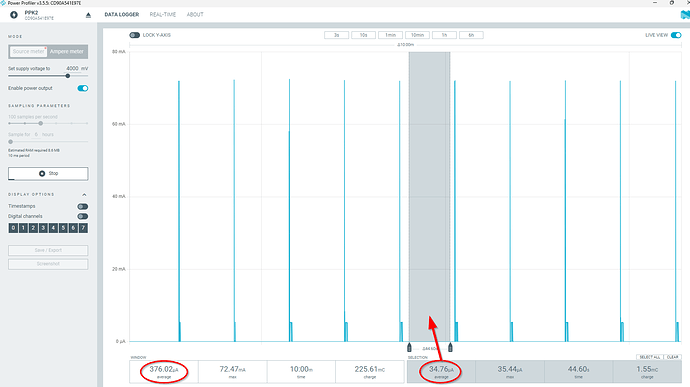

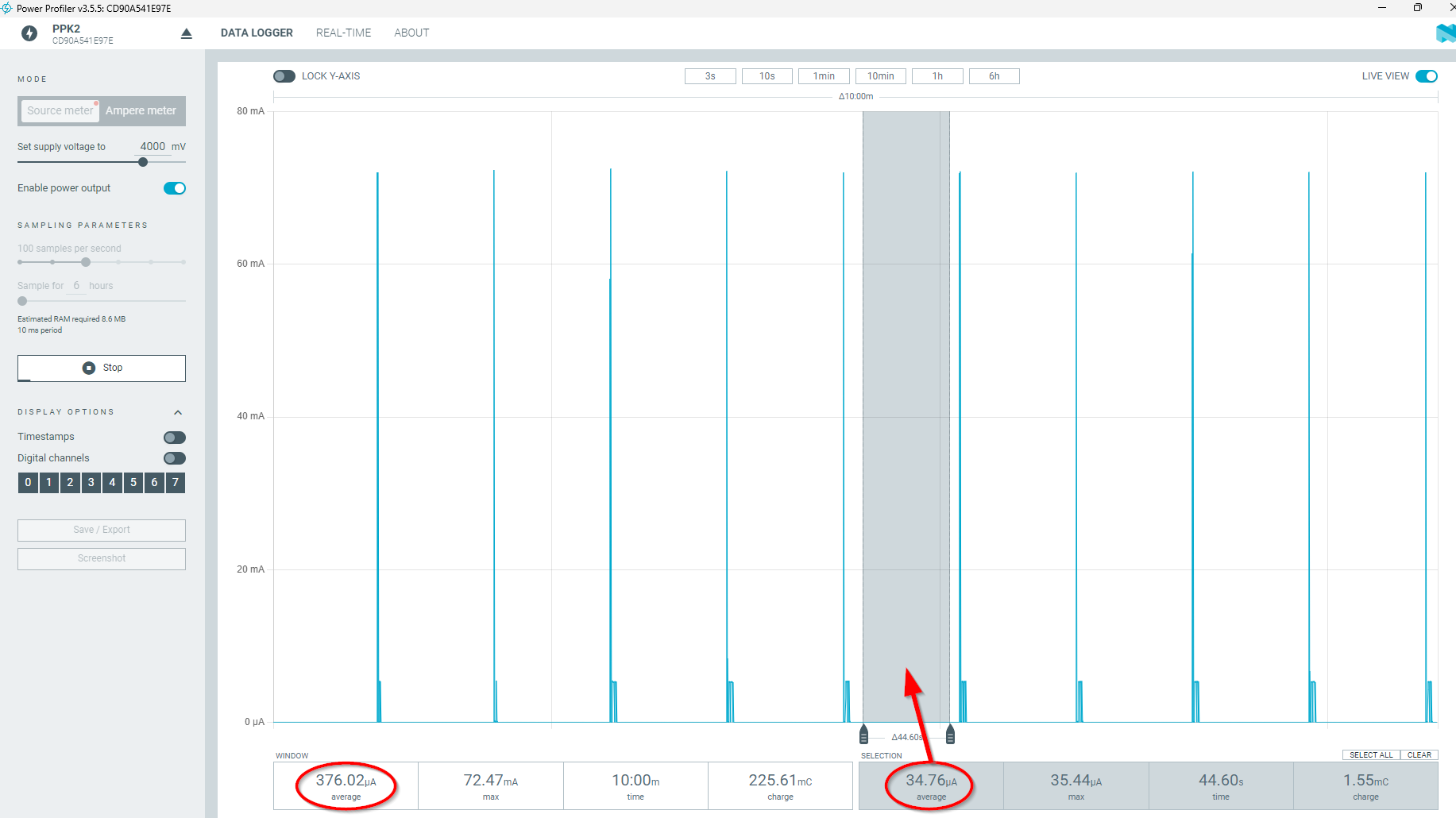

Example measurement from a RAK4631 on a RAK19007. Sending every 60 seconds on AS923-3 with max TX power.~34uA sleep current, but that is not relevant because of the send interval of 1 minute,
