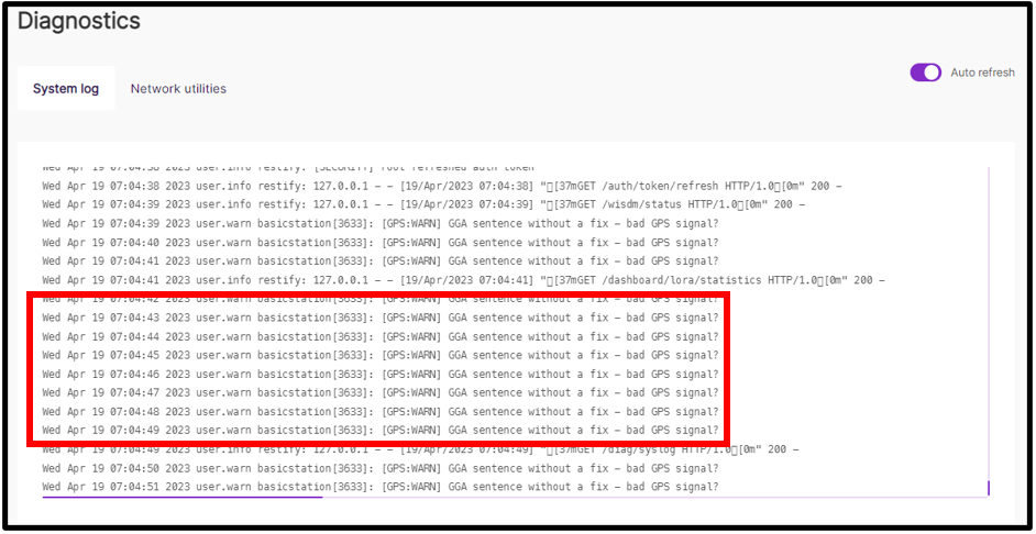

Hello, we have the problem that many error messages corresponding to GPS appear in the LOG. We would like to know how we can disable GPS so that it does not invade the log with those error records.
For example:
Tue Apr 18 10:20:07 2023 user.warn basicstation[12347]: [GPS:WARN] GGA sentence without a fix - bad GPS signal?
Tue Apr 18 10:20:08 2023 user.warn basicstation[12347]: [GPS:WARN] GGA sentence without a fix - bad GPS signal?

Our Gateway has WisGateOS V2, additionally I would like to tell you that for our use case at the moment we are not interested in using the GPS function of the Gateway, we are doing other tests, however, when we go to see the logs many GPS errors appear, We would like to see the possibility of these errors not being shown in the log, I don’t know if that would be possible by disabling GPS or something similar.
You can not stop the GPS log messages specifically.
What you can do is lower the Log level below the warning so you won’t see these messages, but the problem here would be if you need messages that are on level warning or above other than the GPS warnings.

I understand, I thought that from the console there was some command or some change could be made to disable the GPS.
I understand what you’re telling me about lowering the log level, I did some testing and I can see that if I put it below warning I can’t see the logs and data being sent by the end devices.
