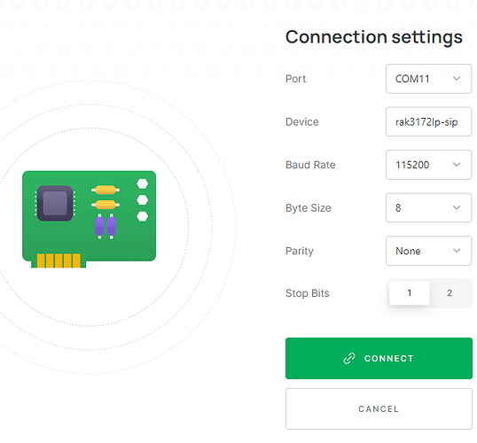

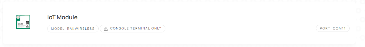

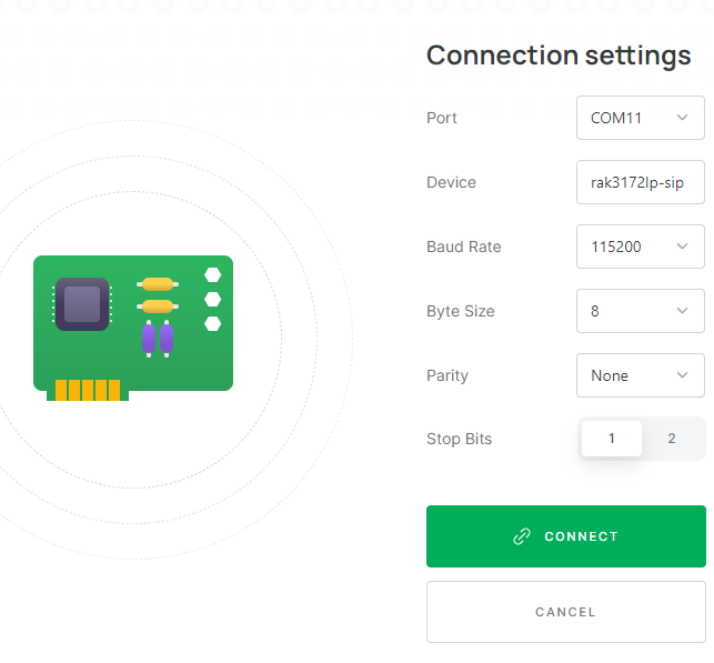

Hello,
I have an issue with the RAK3272LP-SIP module.
Setup:
  • Board: RAK3272LP-SIP
  • WisToolBox v1.4.6
  • RUI3 firmware 4.2.3 flashed via DFU Tool (arrived with 4.0.5)
The problem is that WisToolBox does not recognize the module after connecting it to the computer.
I am attaching photos showing the setup and the behavior in WisToolBox.
Has anyone encountered a similar issue or knows what might be causing this?
Thank you for any suggestions.
