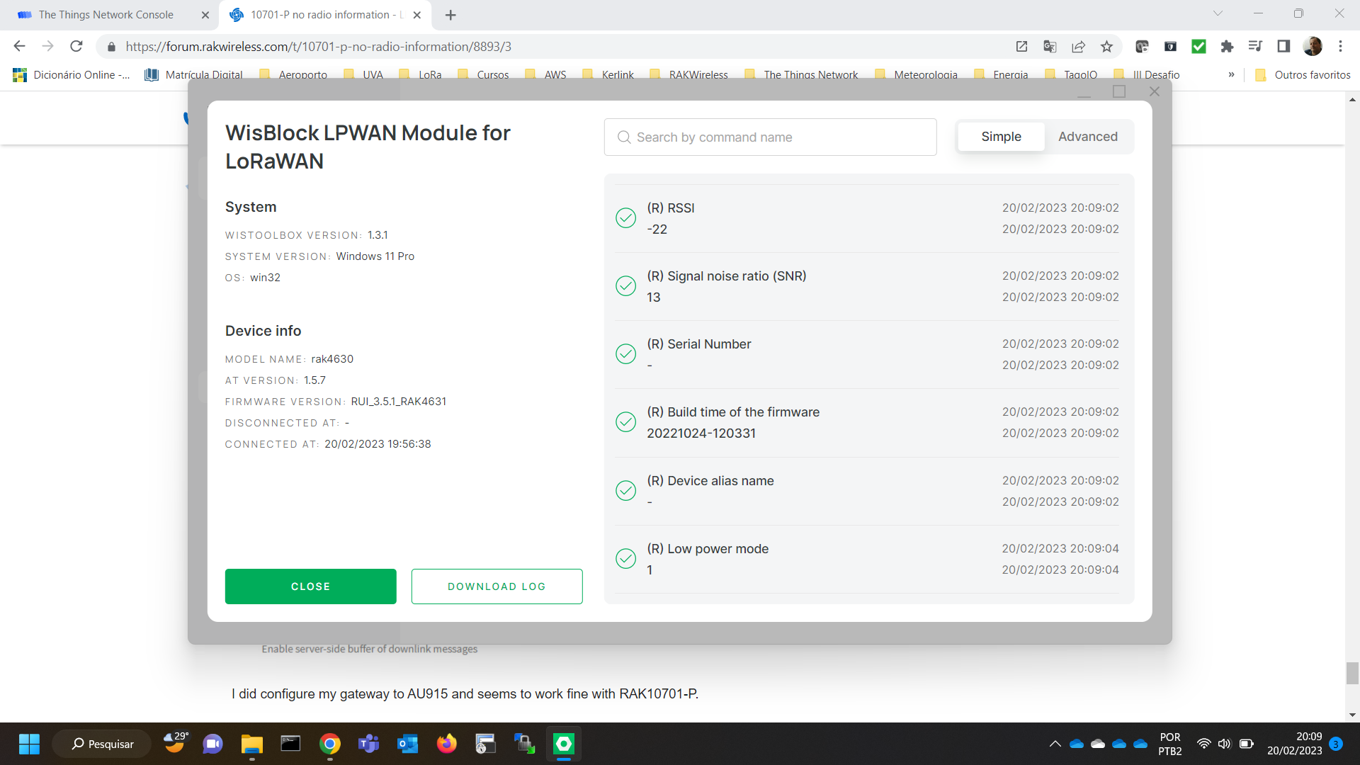

This week I received my 10701-P and now I am testing it.
Well I did the configuration for Brazilian zone as AU915 and I got the JOINED from TTN in the endnode log messages I am seeing all the gateway information for this device, but as you can see in the photo, I am receiving no radio informations, I mean: no gateway quantities, no RSSI, no Distance, but I have lat/long information from GPS.
I did the last version firmware by WisToolBox.
Any ideas?

Other strange information, TTNV3 has a successfull join operation but in the device 10701-P the display is showing a error message FAILED
The TTNV3 log message in JSON format:

Welcome back to RAK forum @crmrosa ,
Were you able to make the unit working before on a different band?
As a look on the logs, it looks like you are using sub-band 1.
Maybe you can try to use sub-band 2?
I did configure my gateway to AU915 and seems to work fine with RAK10701-P.
My RAKWireless gateways are configured in the AU915 FSB 1 channels 0-7,64 to be compliance with the American Tower LoRaWAN network because my client already is working with American Tower.
Is the 10701-P multi-channel or single channel? The manual is not clear about radio specifications.
@carlrowan
Well, I changed the channel plan for FSB 2 channel 8, but no different behavior, I mean no radio information at LCD, but again I can see them in the WisToolBox message log: RSSI, SNR, etc…
Then, I went back to the FSB 1.
It seems to be something like a bug in the process to send radio informations to the LCD.
What do you think?
I am not sure yet but we can assume those hypothesis.
Btw @crmrosa , you told me uplinks and downlinks seems ok in TTN side.
Will you be able to connect the Field Mapper in PC via USB port then get the serial logs via COM port connection?
You can also use the console of wistoolbox and should see logs like this:
@carlrowan
In the log that you showed, It seems to me that you are configured it is working like a “verbose mode”. How could I make it in this “verbose mode” to do a better troubleshooting?
Do we have some diag commands for Radio health?
