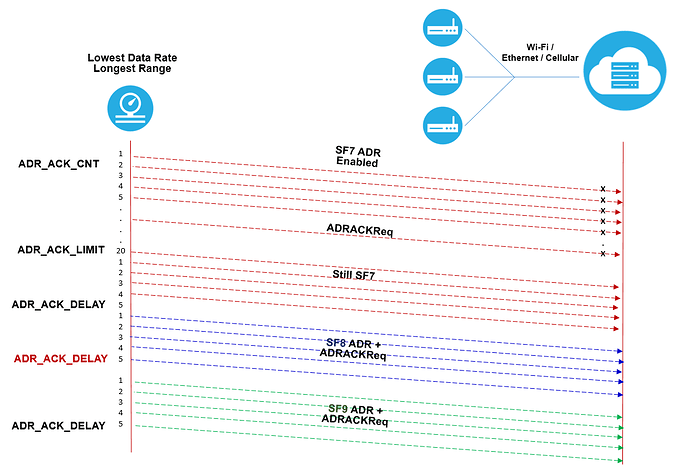

And following this documentation from semtech: Understanding ADR
We could use the following example image to show how RAK3172 will proceed to rise the SF when ADR ON, in a low SF and no answer received from the network:
In the example, the values are 20 and 5… But our values are 64 and 32. That’s it?
Hi @joao_berlese ,
Yes. That is correct. I am not sure why LoRa Alliance used values of 20 and 5 but on the default setting on the regional standard that is 64 and 32.
Personally, I rarely see the 64 and 32 values since I always have a gateway close to me. And whenever I move a device to a different location and start not sending uplinks, I restart the device which means it will start again to a higher SF before optimizing to a lower values.
