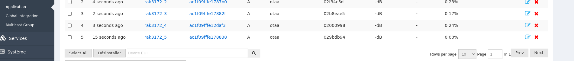

hi

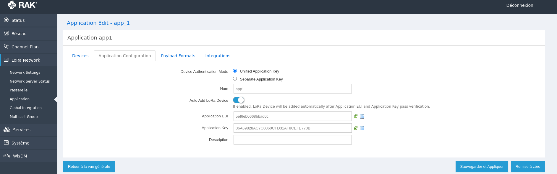

i’m working with rak3172 and gateway rak7289 and i want to make an automate system in which, in order to connect the rak3172 to the gateway, i will not need to enter manually the DevEUI I like this
so i tried to configure here a way to make it automatic by enabling “Auto Add LoRa Device.”
and in the code of rak3172 i configured it like this

but the device didn’t autoadd. i even tried “#define OTAA_APPEUI {0x5e, 0xf6, 0xeb, 0x06, 0x68, 0xbb, 0xad, 0x0c}”
because i doubt in Application EUI is Little Endian in Firmware
so how to fix this problem
