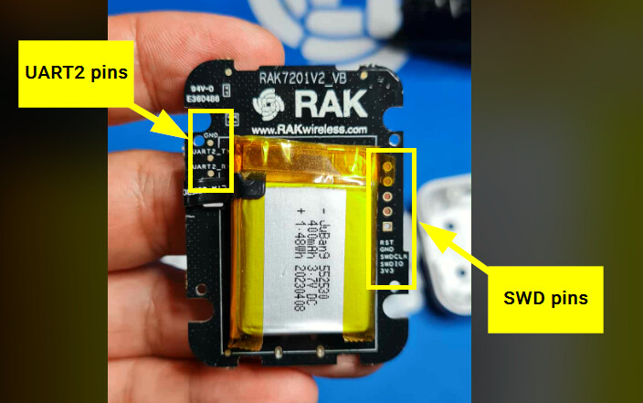

You have to access the internals of RAK7201 then you have two options: (1) use Jlink, RAKDAP1 or other external debugger/programmer that works with STM32WL or (2) use UART pins then use STM32CubeProgrammer.

For first method, you can easily see the SWD pins for connecting your debugger/programmer.

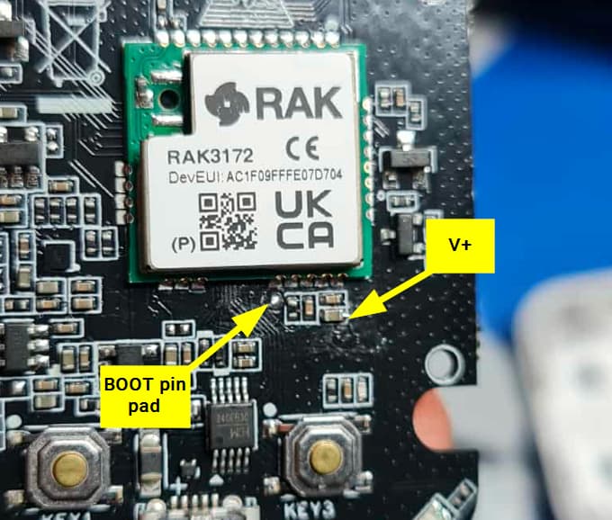

For the second method, you need the UART2 pins then manually pullup the BOOT pin then reset. So for me, I soldered a pin there then connect it to V+ of the supply.
Complete guide on use STM32CubeProgrammer is here - https://learn.rakwireless.com/hc/en-us/articles/26687606549911-How-To-Guide-STM32CubeProgrammer-for-RAK-Modules
