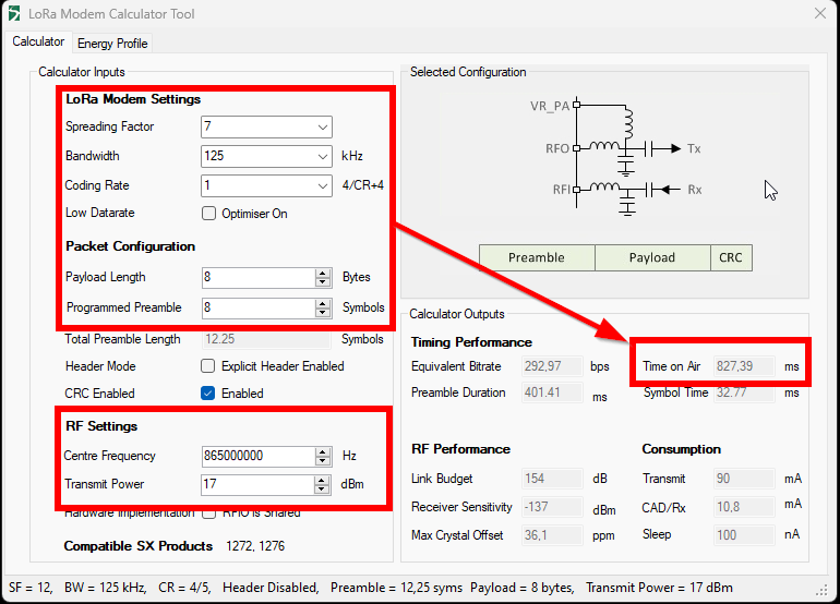

A transmission of only 8 bytes with your settings will take already ~830 milliseconds.
In other words, are you suggesting that the delay before responding should be a bit longer than the Air time?
900 ms for example.
It depends on your payload size and transmission settings.
You can use the calculator tool from Semtech to get the minimum delay between two transmissions.
The tool I used is an old one, they have now an online version:
