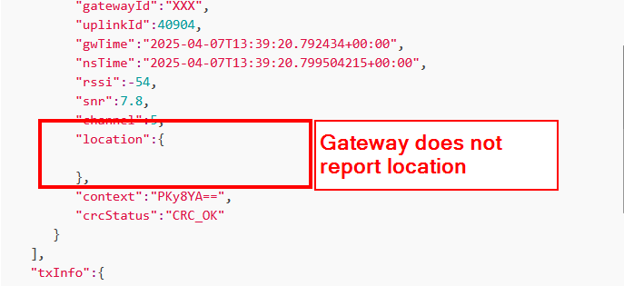

I am trying to get the RAK10701 field tester to work.
I am following the instructions in RAK10701-L Field Tester for LoRaWAN Quick Start Guide (Chirpstack + Datacake)
The field tester is sending the payload to Chirpstack and it is forwarded to Datacake.
But the Decoder does not work:
json: unsupported value: NaN
The received payload looks like this:

"rxInfo":[
"gatewayId":"XXX",
"uplinkId":40904,
"gwTime":"2025-04-07T13:39:20.792434+00:00",
"nsTime":"2025-04-07T13:39:20.799504215+00:00",
"rssi":-54,
"snr":7.8,
"channel":5,
"location":{
"context":"PKy8YA==",
"crcStatus":"CRC_OK"

I am using the Github Script “RAK10701-FieldTester.js” as Decoder in Datacake, is that correct?
