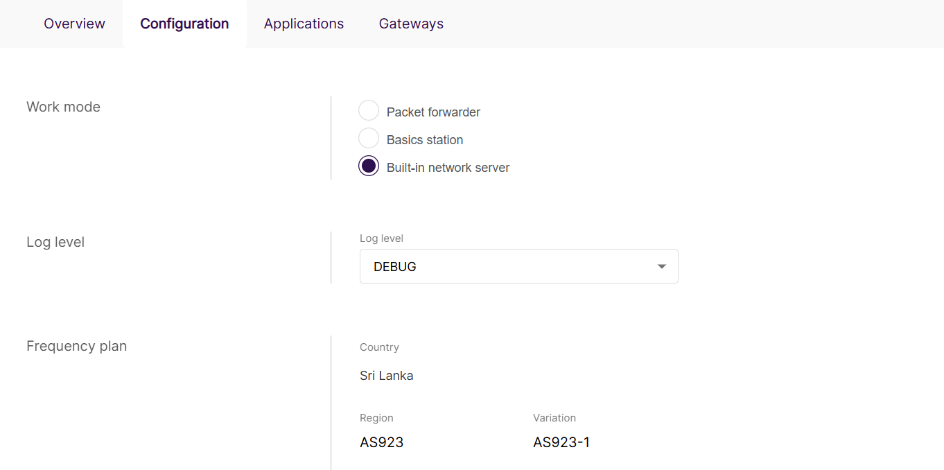

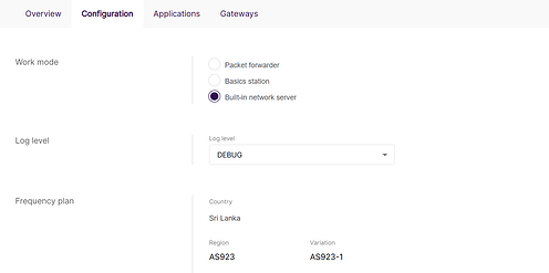

Hi @Saarankan,
I would appreciate it if you shared your WisGateOS 2 built-in network server configuration screen. Also, what kind of RTOS or platform such as RUI3 is running on?
Hi,
STM32 HAL with the LoRaWAN middleware
Hi @Saarankan,
Have you tried joining with another LoRaWAN-ready device node, such as RUI3? The STM32Cube HAL has a lot of low-level configuration.
