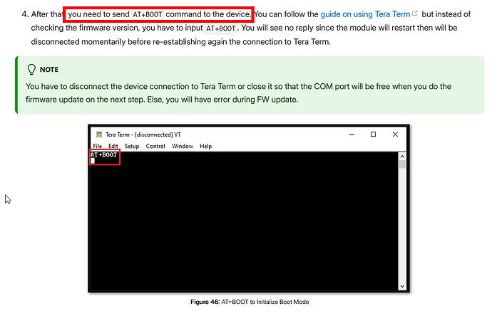

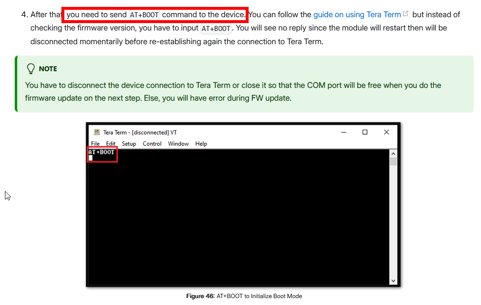

Did you type AT+BOOT in terraterm?
The log says that the default RAK10701 firmware is still running.

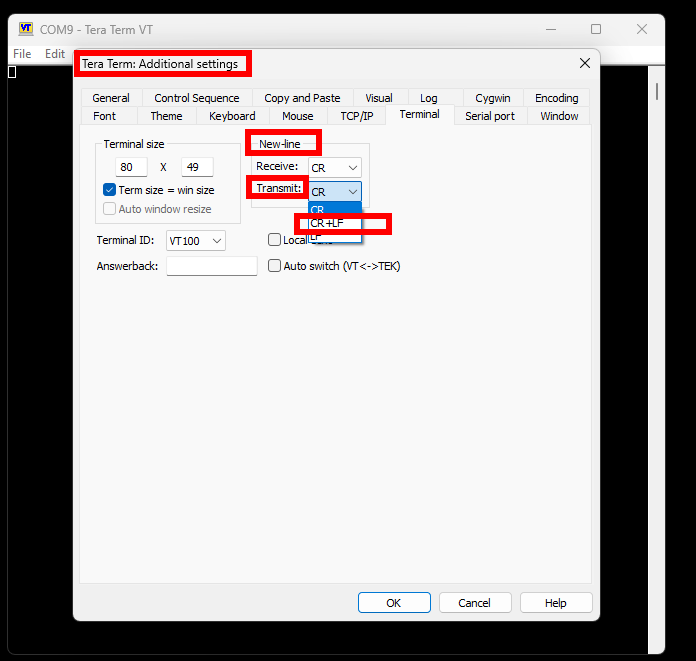

AT+BOOT must have a trailing \r\n. You need to setup this in teraterm.

If the device receives the AT+BOOT command, it will respond with
Unless you see that, the device didn’t get the command.
Check your terminal settings for the correct settings.

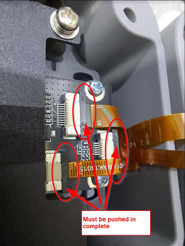

I digged a little bit into the RAK10701 firmware.
[ERR 1]:TP initialization failed. points to a hardware problem with the touch screen.
I guess this needs to be fixed first.
A potential problem with the touch screen is a loose FPC cable inside.
Can you check the FPC connections inside the device:
