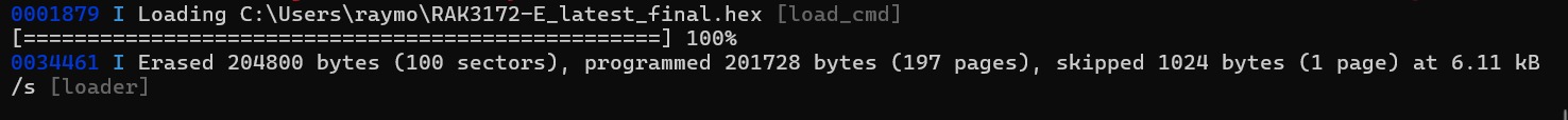

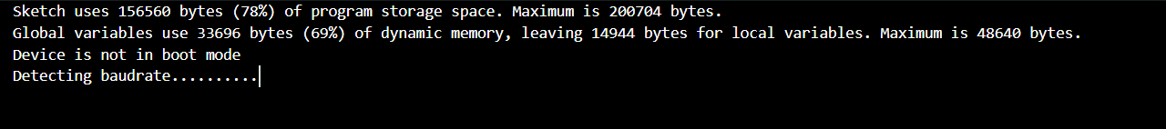

Flashing with rakdap1 is done but AT command is not working in RAK3172
we used RAKDAP1 to debug RAK31720 AND have followed all the steps as per the guide we got the same output as the memory erased but still the AT command is not working and the code is not uploading.
Could you help me to solve the issue.

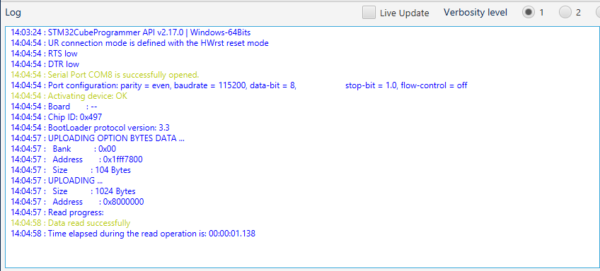

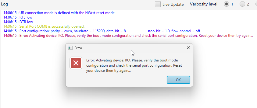

Just an idea to check the connectivity and your USB-Serial converter.
  • Get STM32CubeProgrammer
  • Connect device with your USB Serial converter to the computer
  • Pull BOOT0 pin to 3V3
  • Power up the RAK3172 (or initiate a RESET)

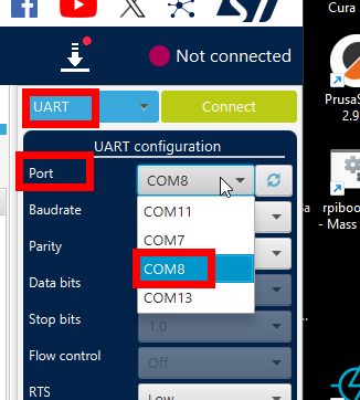

  • Select correct USB port (under UART) in STM32CubeProgrammer
  • Then push Connect
  • If your USB Serial converter is connected correct, STM32CubeProgrammer can connect to the RAK3172
  • If the connection does not work, you will get an error message
