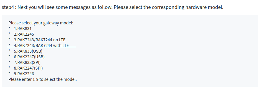

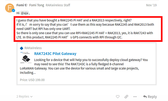

@ecoloch
You can find the reply from fomi in the front.
You can find the installation tutorial from here
https://github.com/RAKWireless/rak_common_for_gateway.

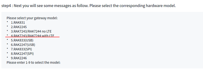

@ecoloch

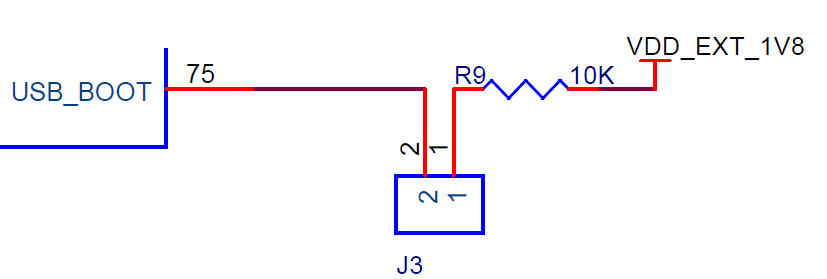

another question on the same topic, what does the jumper J3 do exactly on the RAK2013 board .
J3 is a jumper which connects to USB_BOOT and 1.8V pull high.During development or factory production, USB_BOOT can force the module to boot from USB port for firmware upgrade.
