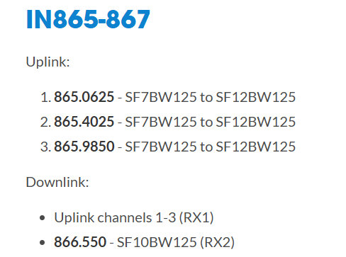

Can you guide me through the frequency bands and channel allocations used in India for lorawan wireless communication?
Welcome to RAK forum @Khalid1999 ,
This is the frequency allocation for India.
