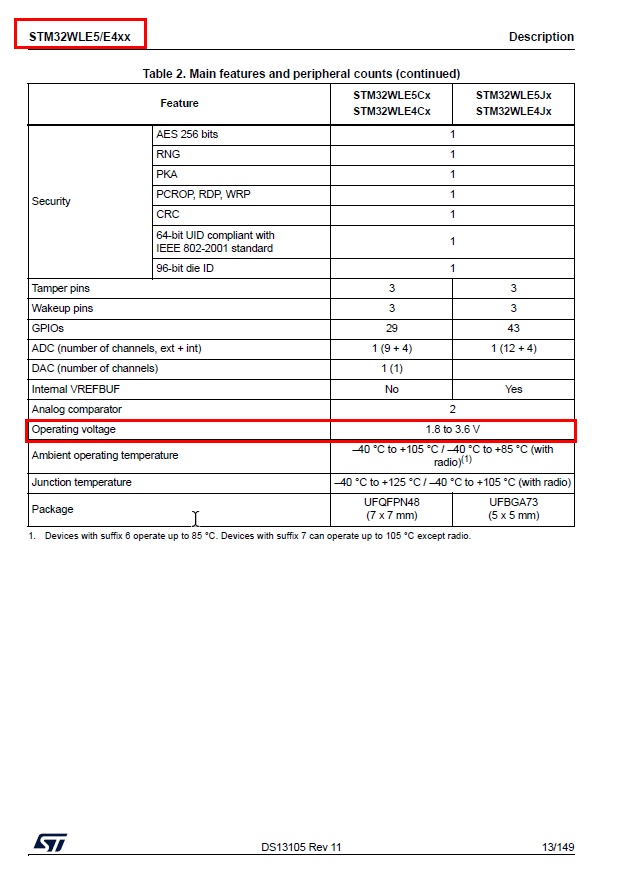

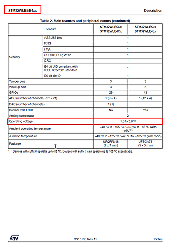

STM32WLE5 has a operating voltage of 1.8 to 3.6V

:bone: Until it dies :skull::
