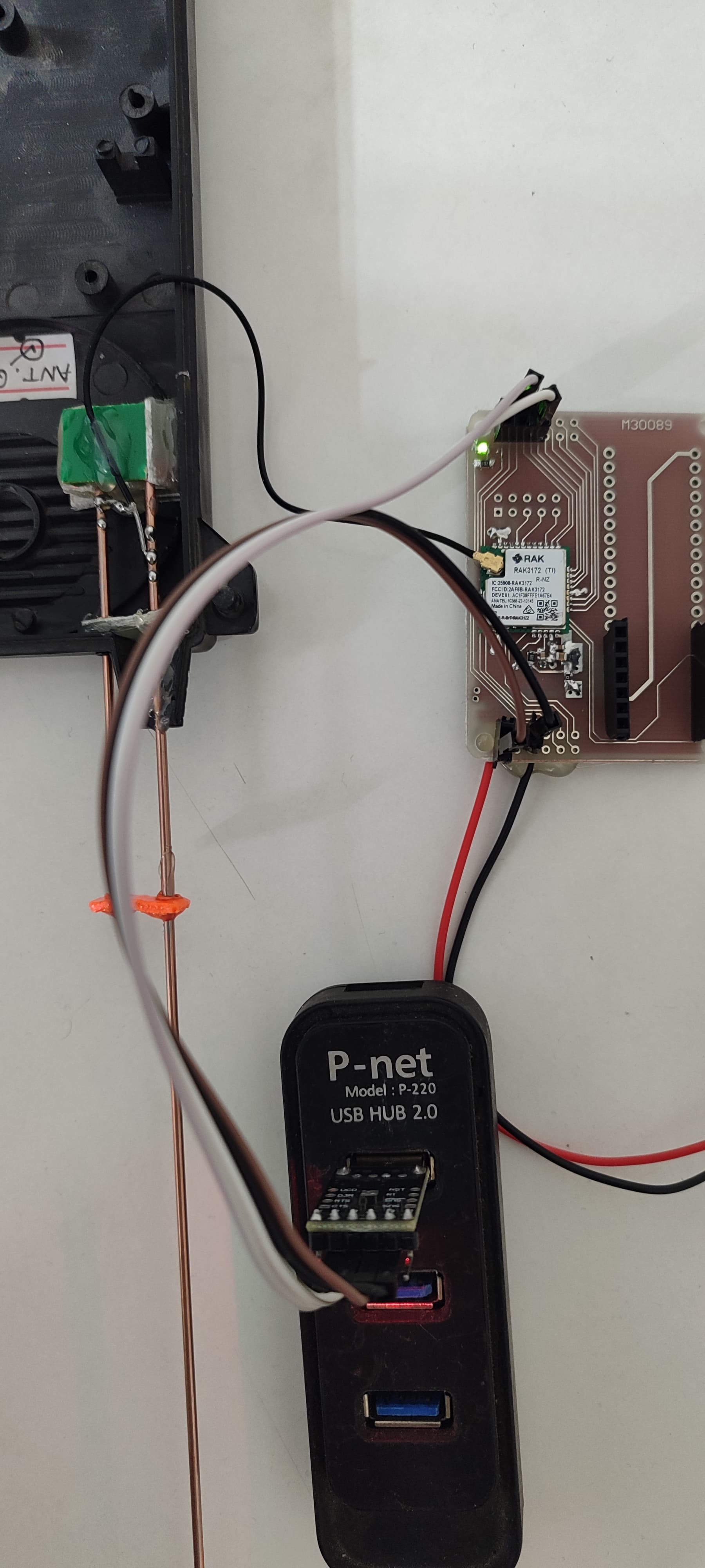

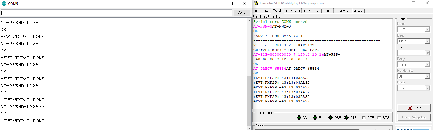

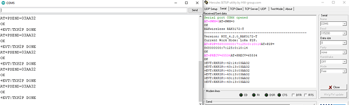

Hi,
I upgrade the framware (Version: RUI_4.2.0_RAK3172-E Current Work Mode: LoRa P2P.)
one node as TX:
AT+P2P=868000000:7:125:0:10:14
P2P_RX_ON already, please disable P2P RX before setting.
AT_BUSY_ERROR
AT+PRECV=0
OK
OK
AT+PSEND=03
OK
AT+PSEND=03
AT_BUSY_ERROR
AT+PSEND=03
AT_BUSY_ERROR
one node as RX:
OK
AT+PRECV=65534
OK
I can not recieve data in RX Both version 4.0.6 or 4.2.0 and I chage SF and Band Frequncy into US915
