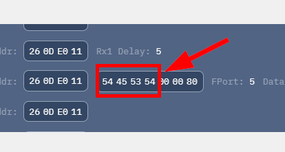

all the documentation talks about a 10 bytes payload coming in f_port:1. I my case I am receiving a 7 bytes payload and from f_port:5 . Do you have the decoder for the 7 bytes coming from fport_5? o the way th change a standar mode?
Hi @Victor ,

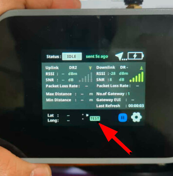

The bytes you get on fport5 represents the label tag. You can see in your TTN console that it shows NULL value.
You can change it in settings. For example, I changed mine to TEST.
This is the payload I will receive which is the hex representation of the ASCII word TEST.

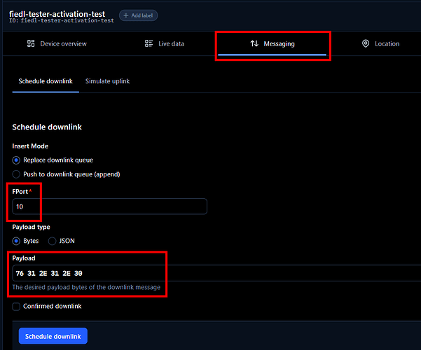

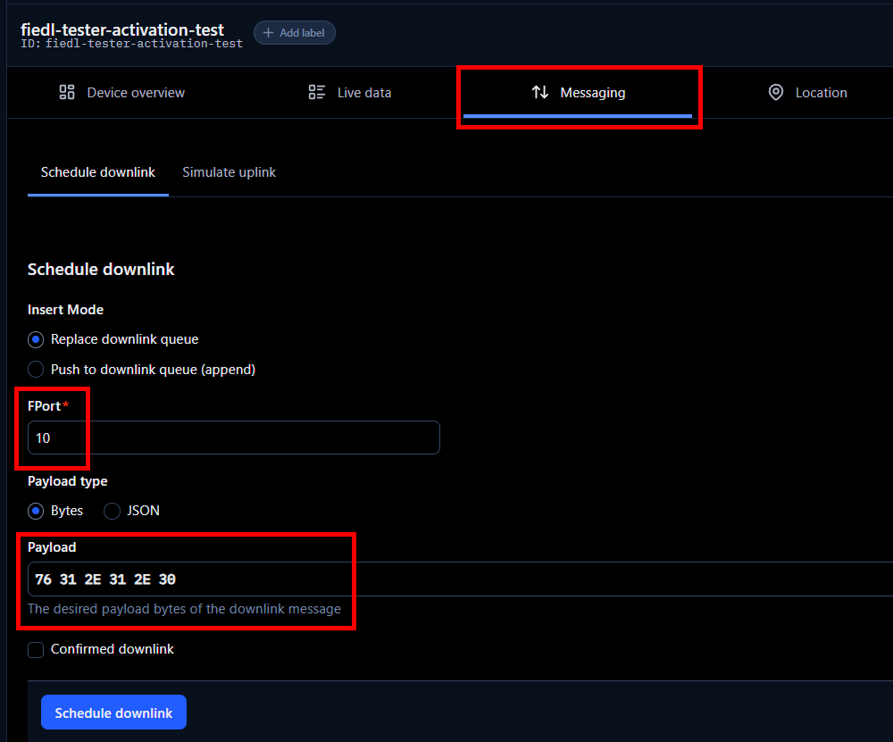

I understand that you use non-RAK gateway. So we can force a manual downlink to activate the payload.
Please send as downlink:
Hex: 76312E312E30
Port:10

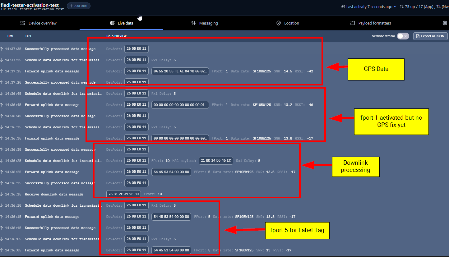

After scheduling and successfully received by the RAK10701-Plus field tester, you should start getting the GPS data on fport1.
Here’s how it should look like.
