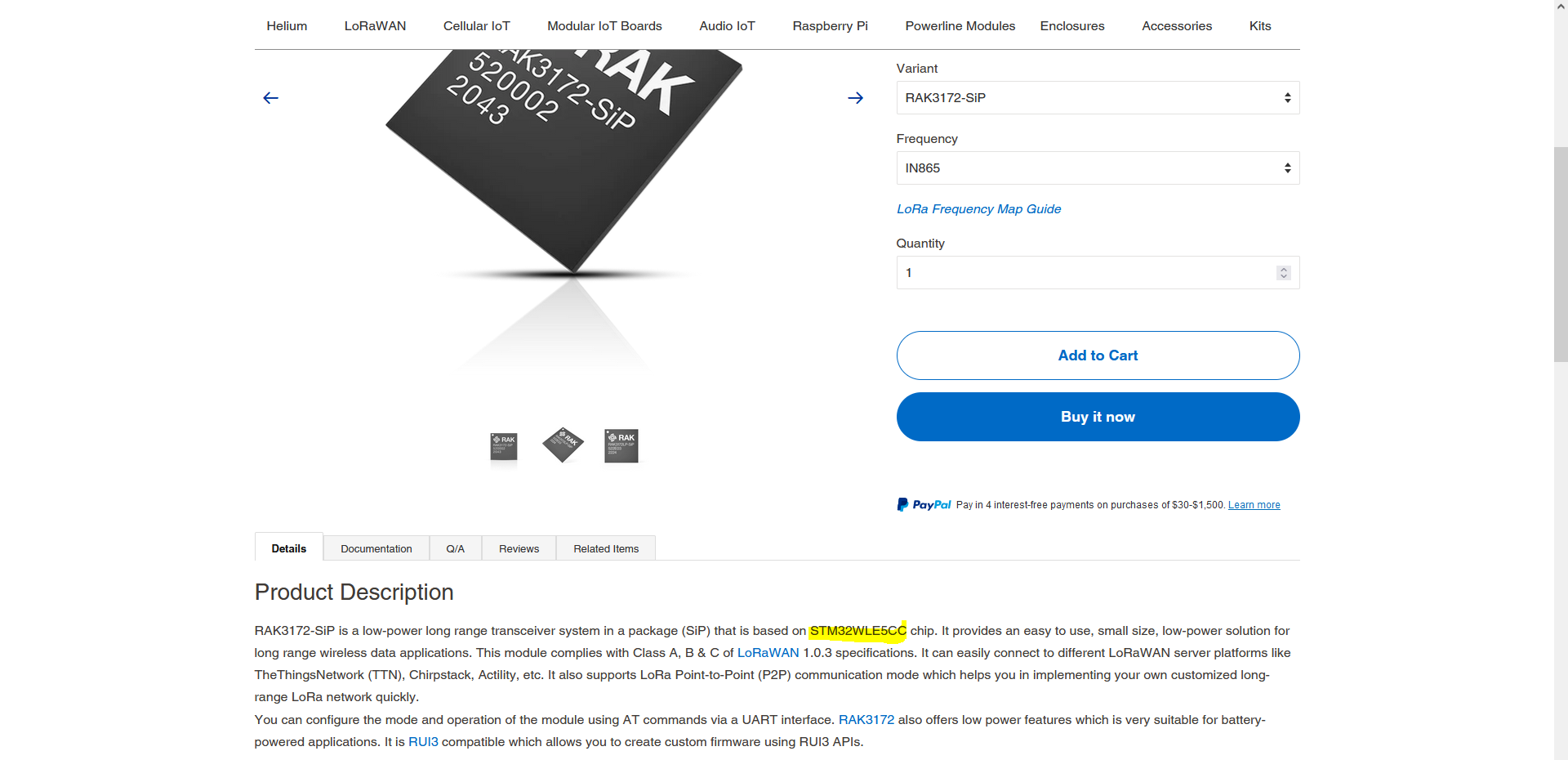

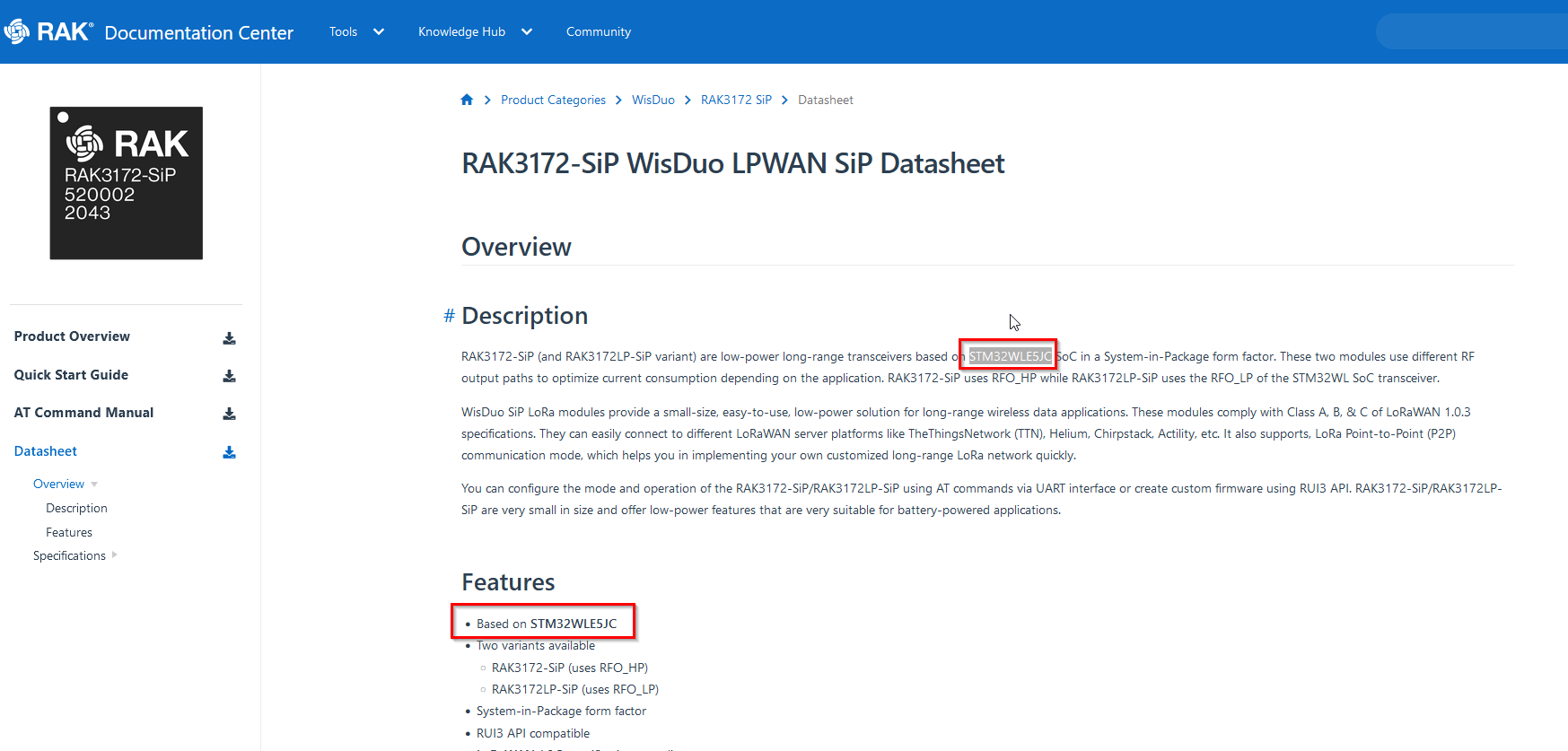

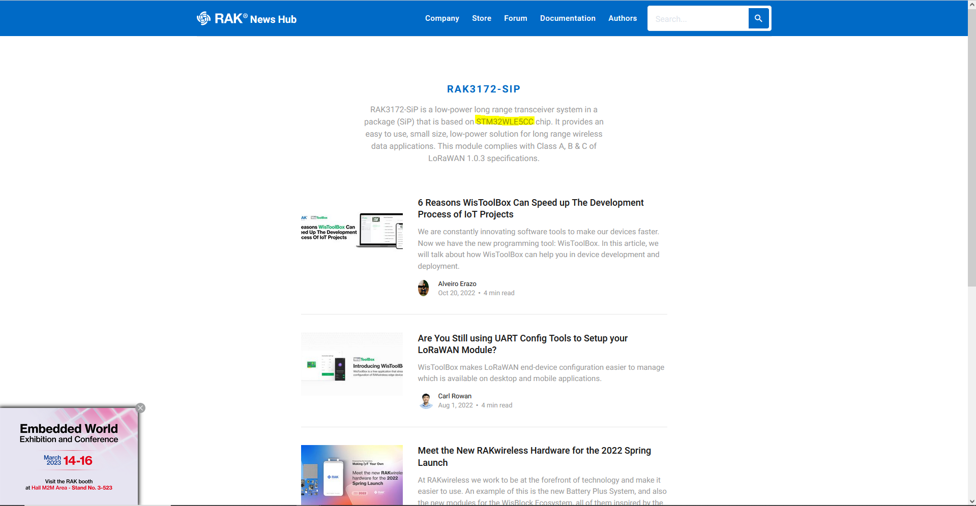

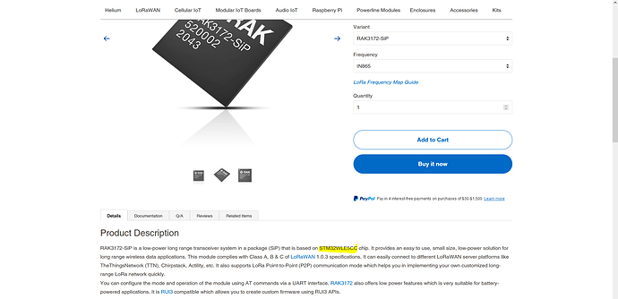

What is STM32 chip is the RAK 3172 SiP based on? The datasheet says STM32WLE5CC whereas all the other places say STM32WLE5JC.
Where did you find the STM32WLE5CC? If it is somewhere in our documentation we need to correct it.
But I cannot find it.
The RAK3172-SiP documents say it is STM32WLE5JC
Thanks, I asked our web team to correct it.
