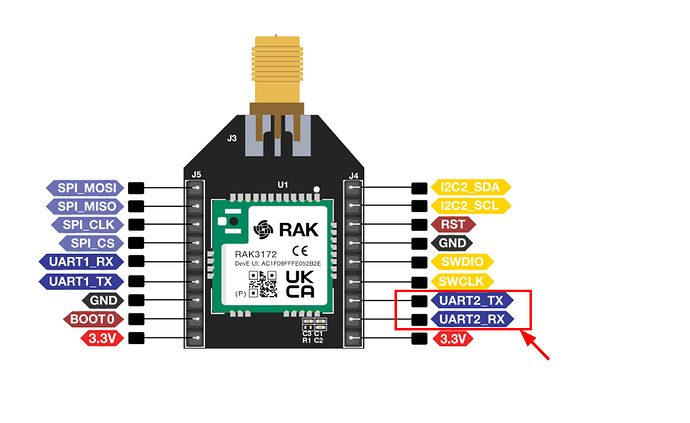

could you send me a schematic for how the boot pins must be connected.
For the RAK3272 Breakout Board, you need to connect the boot pin to 3.3V as shown below. Doing this will make the STM32WL to start on UART bootloader section of the chip instead of the application code.

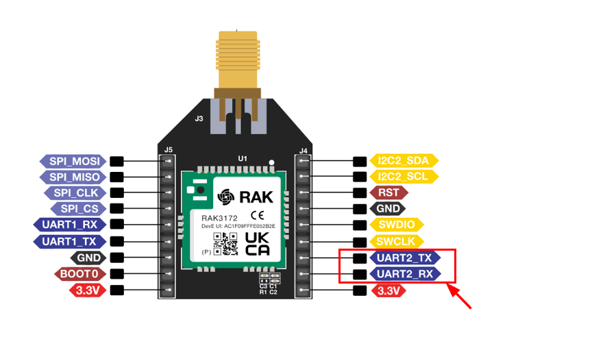

Hi @Wolfe ,
Common mistake is not using UART2. If you connect to UART1, then you cannot see it. Also the baud rate must be 115200.
Thank you I’m gonna go back to it now
Between that and bridging out the boot to 3.3 V on the initial fire up I would never have been able to sort it out thank you
