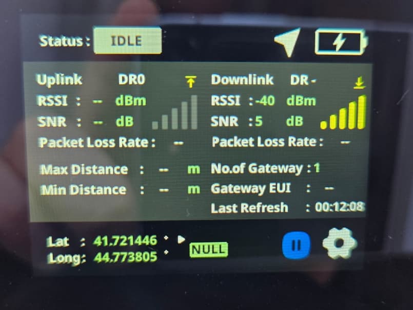

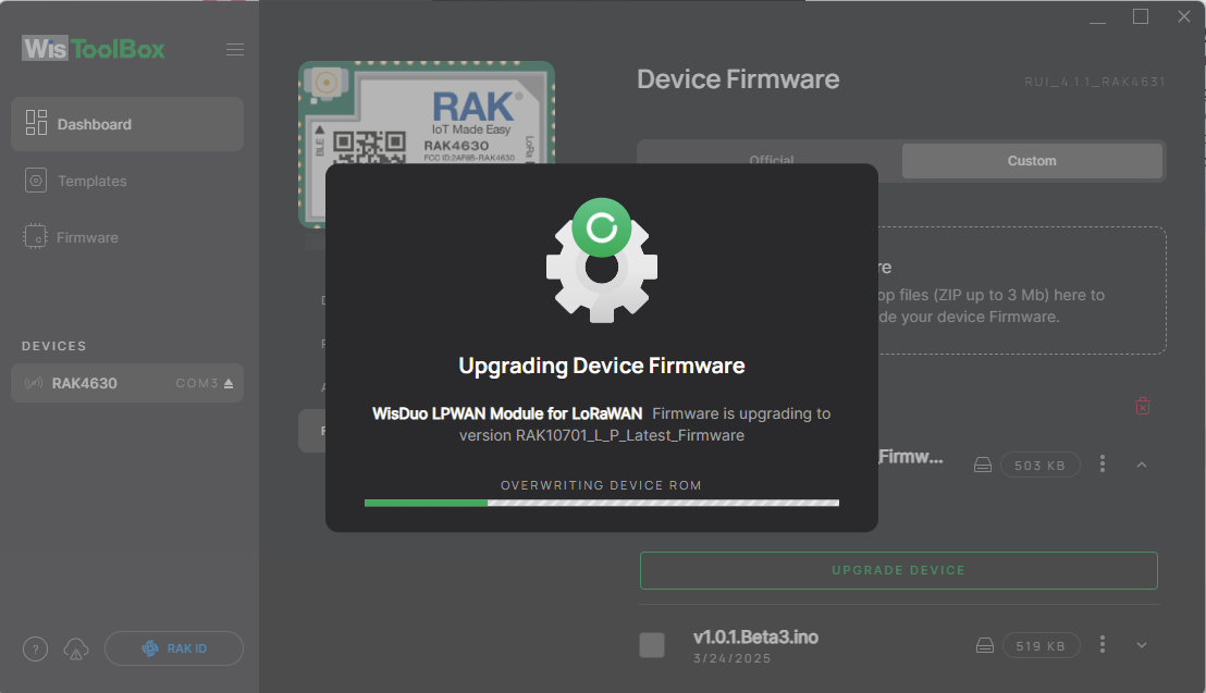

I have updated the fw. I can see the new UI, but I have one small problem now
I lost some stats. I have my own python script running on the chirpstack server side as a service. I am listening to the uplink from the device, then calculating the gateway distance and putting the Uplink stats back into the queue. It is kind of a loop-back on the server, instead of relying on 3rd party (like datakake).
Anyway, It worked perfectly. I suspect that new FW has different downlink packet structure. Can you help to clarify? What data is expected on the downwind side?

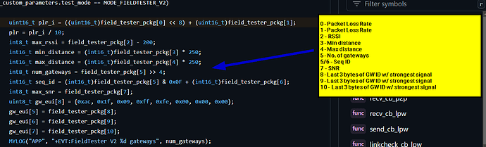

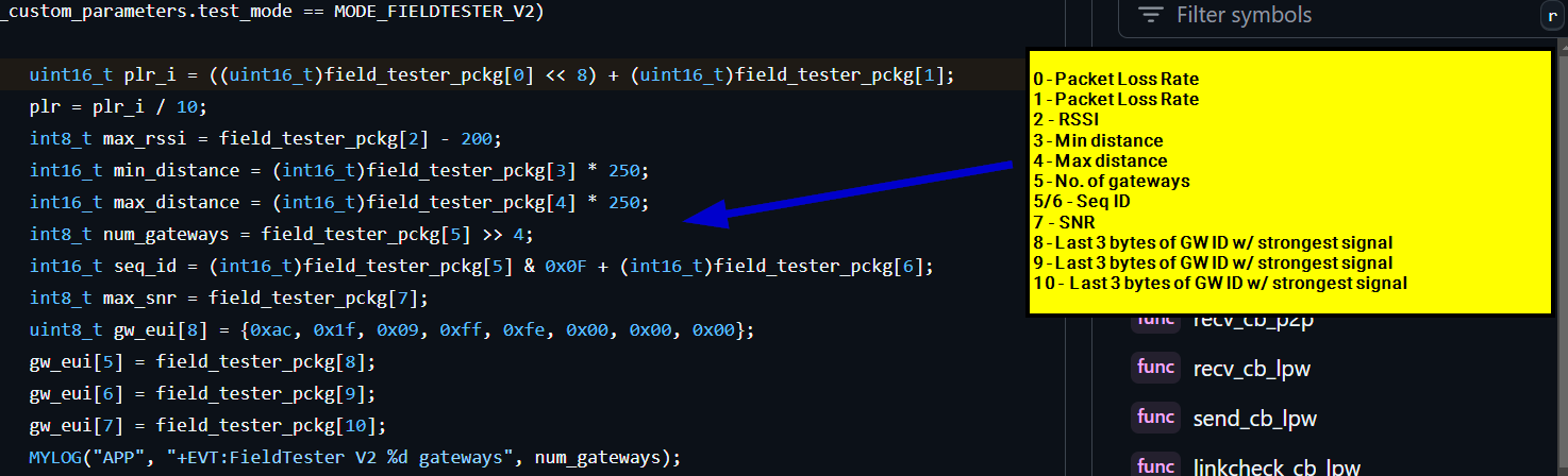

Hi @sergi_jini ,
I have no access to the source code but I can refer you to @beegee 's RAK10706 Signal Meter that also supports RAK10701-Plus (V2) downlink structure implementation. It is open source so you can have a look on his code.
The payload structure starts at line 230 - RAK10706-Signal-Meter/RAK10706-Signal-Meter.ino at 80292f995af18c32a77716596dad724e06242ee4 · RAKWireless/RAK10706-Signal-Meter · GitHub
The other stats you need to map are there: uplink rssi, snr, packet loss rate (plr), min/max distance, etc.

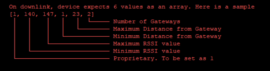

Hello @beegee , I would appreciate if you can help to understand the downlink packet structure for the new SW of RAK10706
To put it simple, I need to know what changed in the below > this used to work on older version.
many thanks in advance

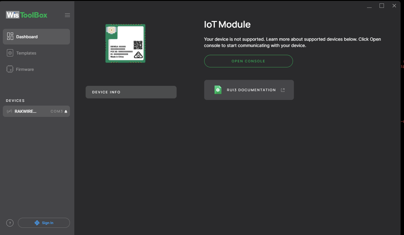

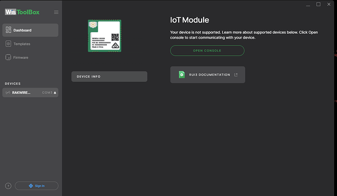

So I tried to roll back the firmware, but now it is not getting detected by Wistoolbox at all ![]()
How I can flush the previous version?
Hi @sergi_jini ,
Moving back from RAK10701-Plus to RAK10701 is not yet supported by WisToolbox.
You have to upload first a plain FW to the RAK4631 inside the RAK10701-Plus then upload the RAK10701 FW. You have to use Arduino IDE you can follow this tutorial.

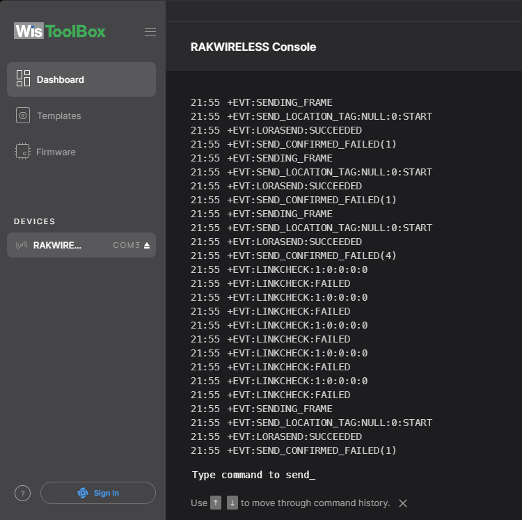

Hi @carlrowan
Nice video tutorial. I have flashed the blinky via Arduino IDE and then RAK10701 FW via Wistoolbox.

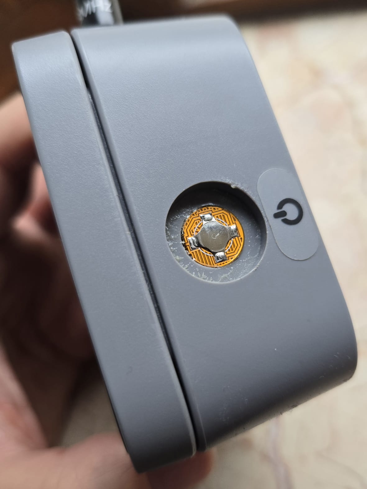

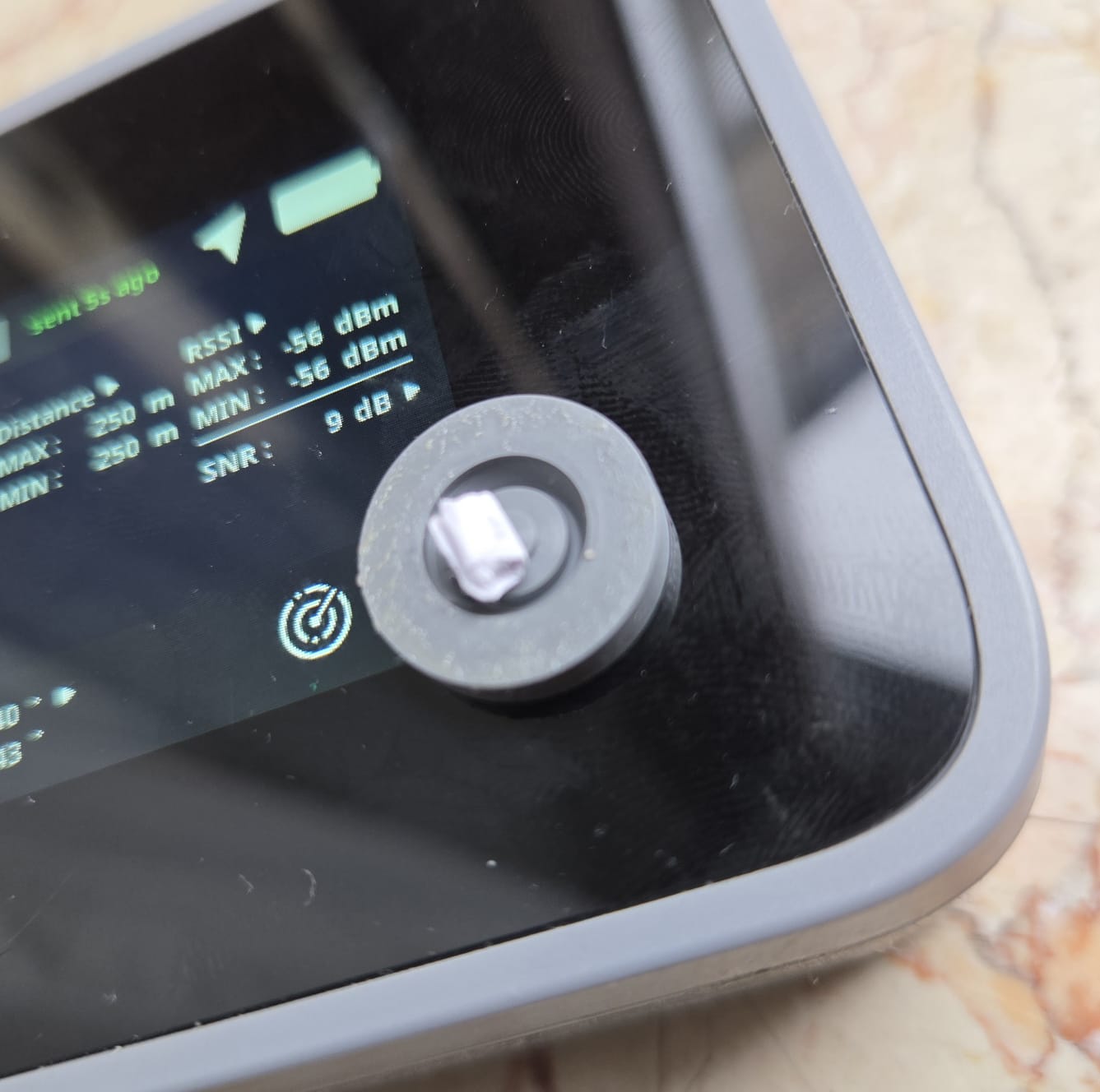

All looked fine until I noticed that the side button does not function anymore. I did visual inspection of the button/connector, all looks fine. Did you ever come across such behavior?
I will try to reflash again today.
Alright. Side button malfunction was due to mechanical problem. Seems the membrane was worn down (I have it since 2023). I put a small piece of folded paper between button and the rubber cap for now and it works

I already shared your feedback to the team. If you were able to capture some photo about the issue on the button, I can forward to the team as well. It will be helpful on assessment for possible improvement.
Sure.
This button stopped working. I could hear the clicking sound, but seems the contacts inside the membrane got damaged. From outside nothing wrong, solders are still holding, pcb traces also looks fine. It seems more a mechanical issue.
And this is solution > paper
works like a charm now.
