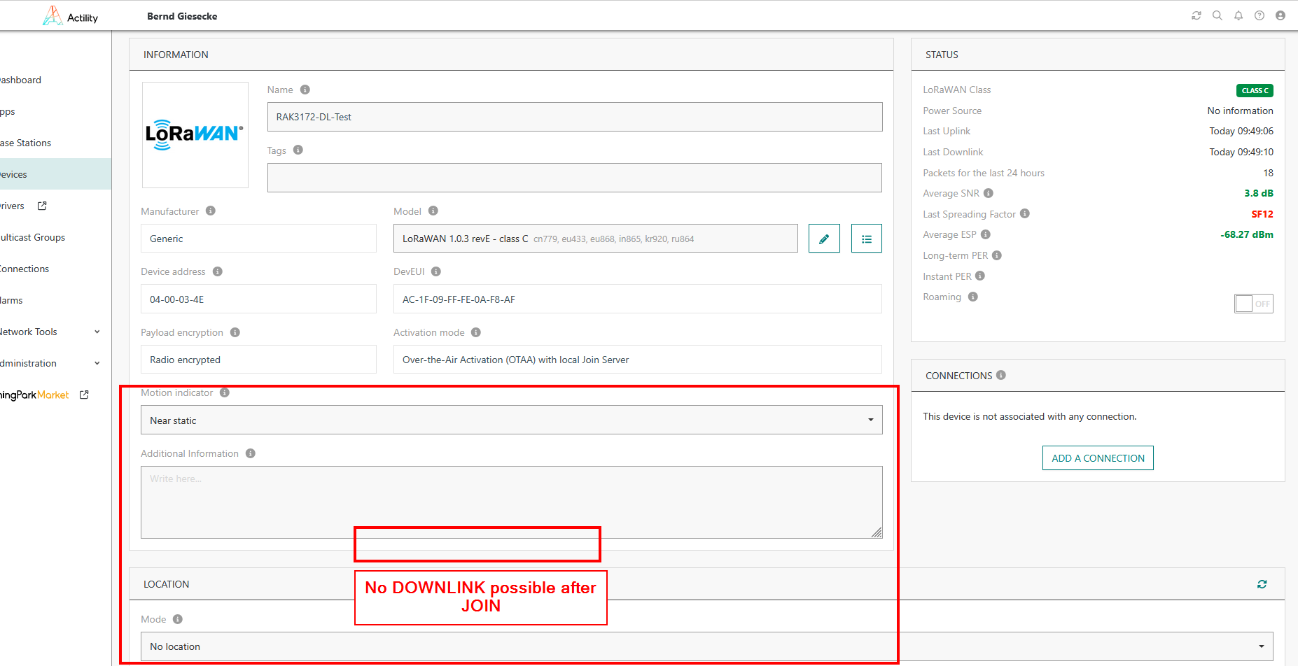

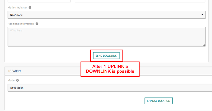

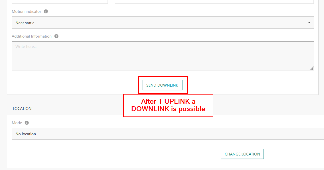

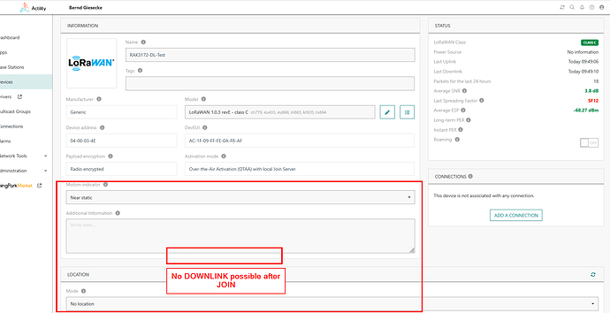

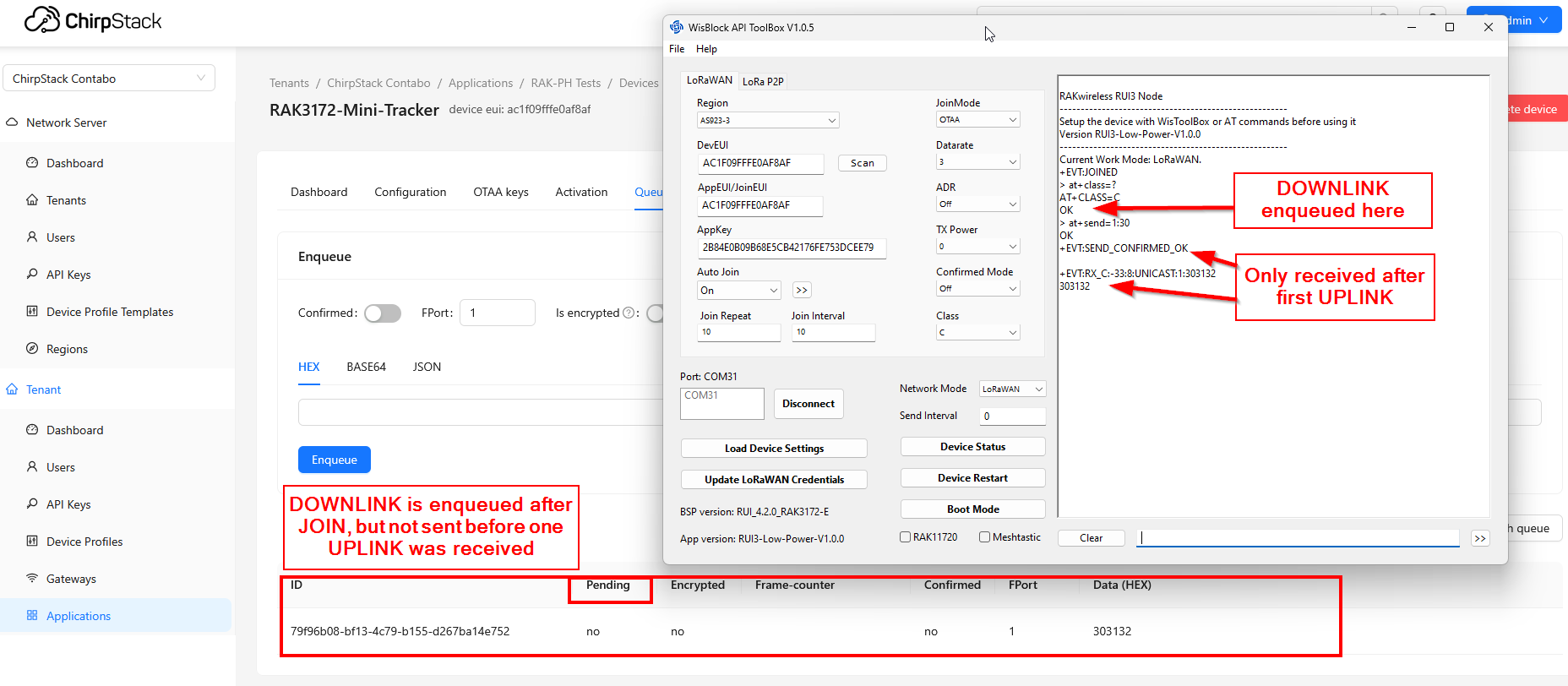

I found this (specific for TTN/TTS):
Problem with sending downlinks before the first uplink
Tested on my Actility connection.
After join, I cannot send a DOWNLINK, the DOWNLINK function is disabled:
After sending one uplink, the DOWNLINK is possible:

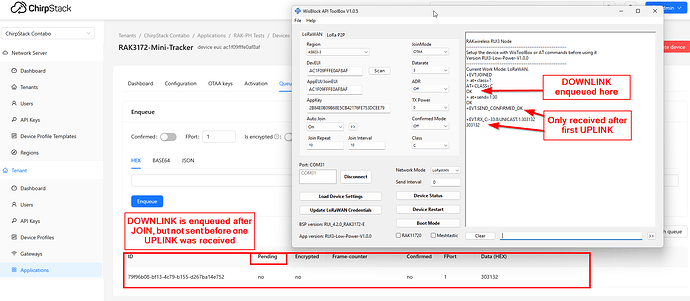

Same on Chirpstack.
After Join, I can enqueue a DOWNLINK, but it is not sent. It needs one UPLINK, then the DOWNLINK is sent.

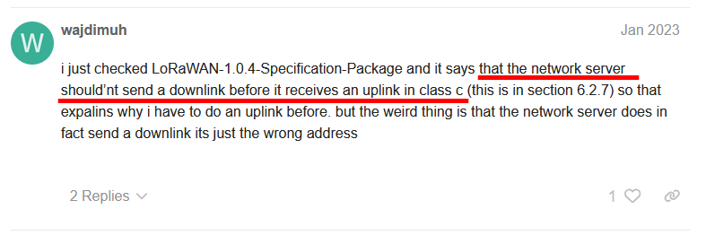

Ok, so it is not a bug but a protocol definition, despite the protocol version differences (1.0.3 vs 1.0.4). I will consider this. This topic can be closed.
