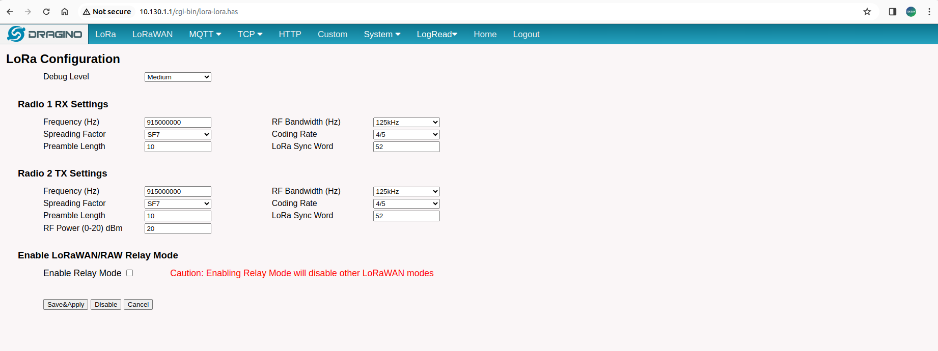

and dragino gateway configuration as per
above image
any suggestion please ?

Thank You for your response @beegee,
we are using Dragino gateway as a node,
not as a server.
we try to do node to node communication between rak3172 and dragino LG02 gateway.
Additionally, i have tested RAK3172 in P2P mode with firmware version 1.0.4 and same dragino LG-02 gateway to get the data which are sent by RAK3172 and it is working above configuration.
And when changing the firmware version of RAK3172 to 4.0.5 it is not working same as version 1.0.4.
Also, I have added syncword with 4.0.5 but still same result. not sure about issue.
can you help to find the solution with version 4.0.5?
