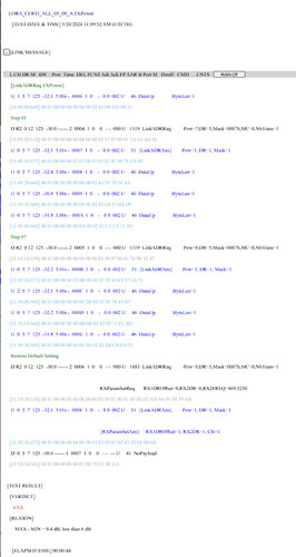

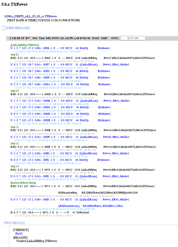

Here is an image of the log:

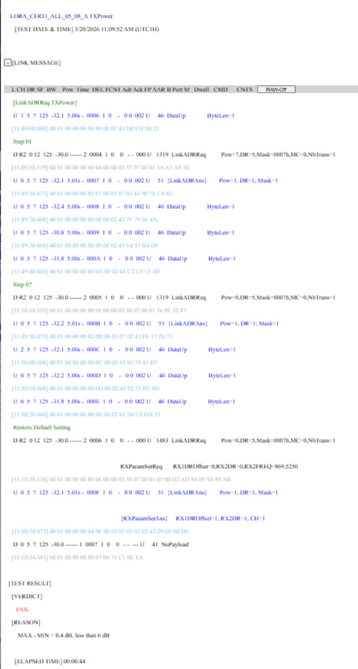

Image attached for reference of test:
I have attempted to put AT+ADR=0, but as soon as i do AT+CERTIF=1, ADR is overridden and set at 1, and of course ADR cannot be manually changed once put into certification mode of the rak3172.
Any other hints about this please? As this is the only test it is not passing when doing a Class A test on the RWC5020b tester.

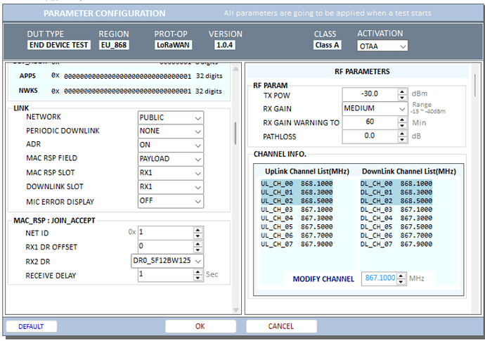

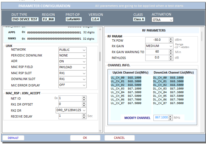

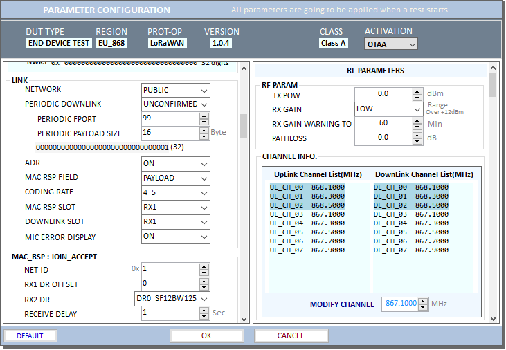

Below find a picture of my settings:

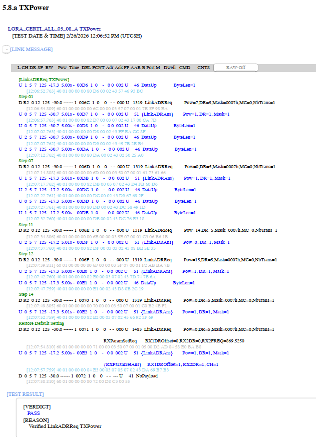

Hello Carl,
I have tested with your settings and the device still failed on the same TX setting. I was looking through the documents and noticed that a blade antenna is needed for the certification. After changing from a PCB antenna to a blade antenna, that seemed to have fixed it and the device is passing from Class A and Certification by similarity now.
