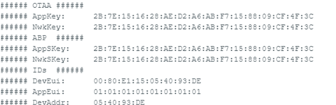

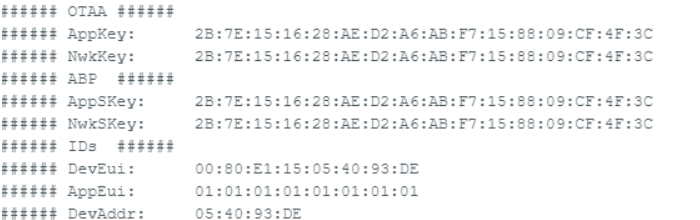

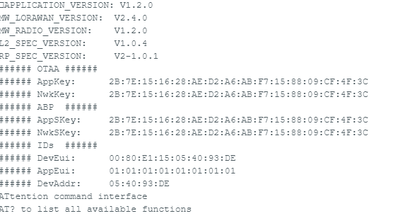

Hello, I was using the example form WisDUORAK3172 Evaluation Board. I want to get the DevEUI that is located in the MCU. I was creating a project at STM32CubeIDE and there was an option to put zeros at DevEUI and the program would use the DevEUI in the MCU. I could get those parameters at STM32CubeIDE, and also creating a program for RAK3172 as AT_SLAVE. These are the parameters i got:

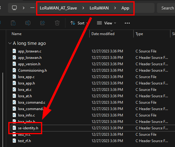

You should be able to modify the keys in secure identify file - se-identity.h.
If you are using AT slave, this is the directory.

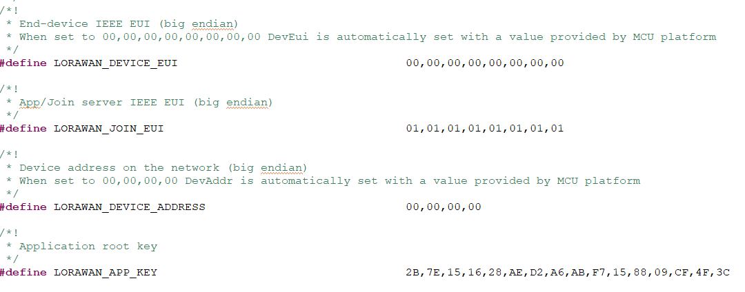

Hello, I don’t put any Device EUI. In this part of the code, It says “When set to 00,00,00,00 DevAddr is automatically set with a value provided by MCU platform”. I want to know if I can got this value in the arduino program, or where can I find this value. Because when I set to "0"s. I get these values:

As for the DevAddr, if you are joining in OTAA mode, this will be automatically updated once you join.
