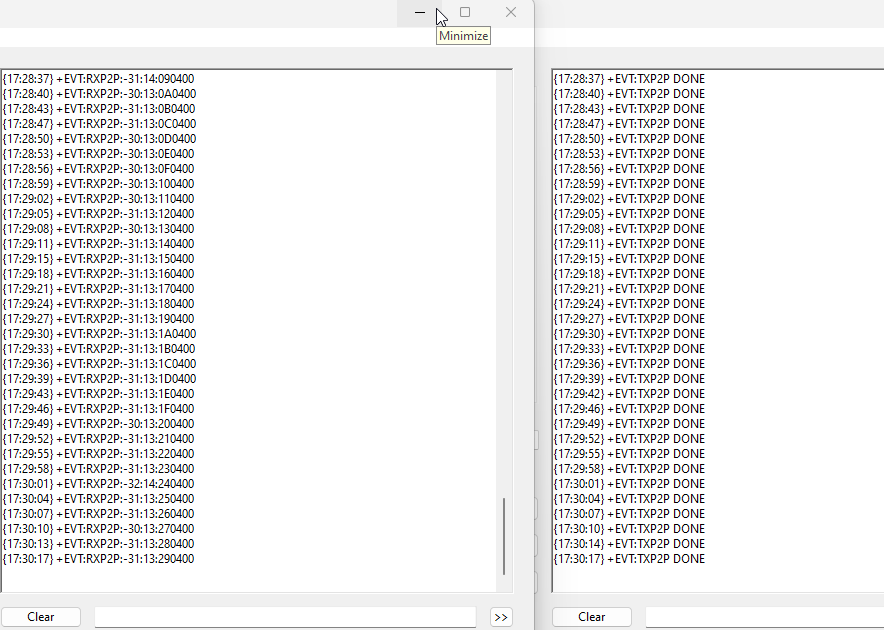

That works:
Personally, I would not use the loop() at all if I want to send every three seconds and instead use a timer.
With api.system.lpm(1); you enable automatic power save mode and the module will go into sleep whenever possible.
With api.system.sleep.all(); in the loop, the loop is disabled and doesn’t consume power.
The send routine will wake up by a timer and initiate the sending. Once the transmission is finished, the system goes into sleep mode by itself.
