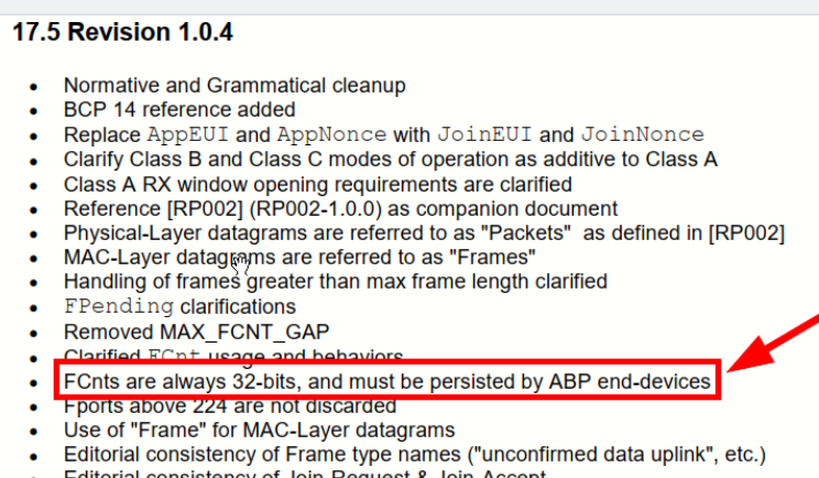

I use a module for evaluation with RUI 4.1.0 and it seems like the frame counters are set back to zero every powercycle. This is bad because even when i keep the module in sleep mode i can not guarantee a continuous power supply.
I think I’m going to use the OTAA approach in combination with sleep mode and perform a rejoin when a power loss happens.
RUI3 4.1.0 is not yet LoRaWAN 1.0.4 compliant where ABP was mandated to have persistent frame counts. You have to use the latest RUI3 FW version - 4.2.3.
One alternative is to disable the framecounter tracking on your LNS side.
