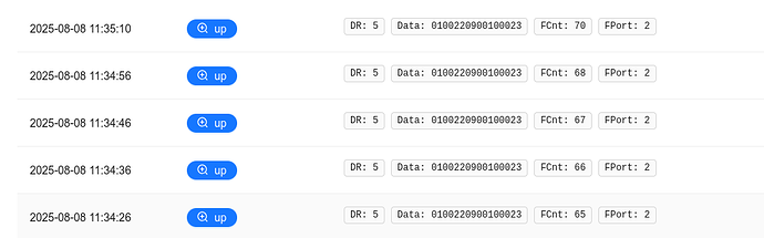

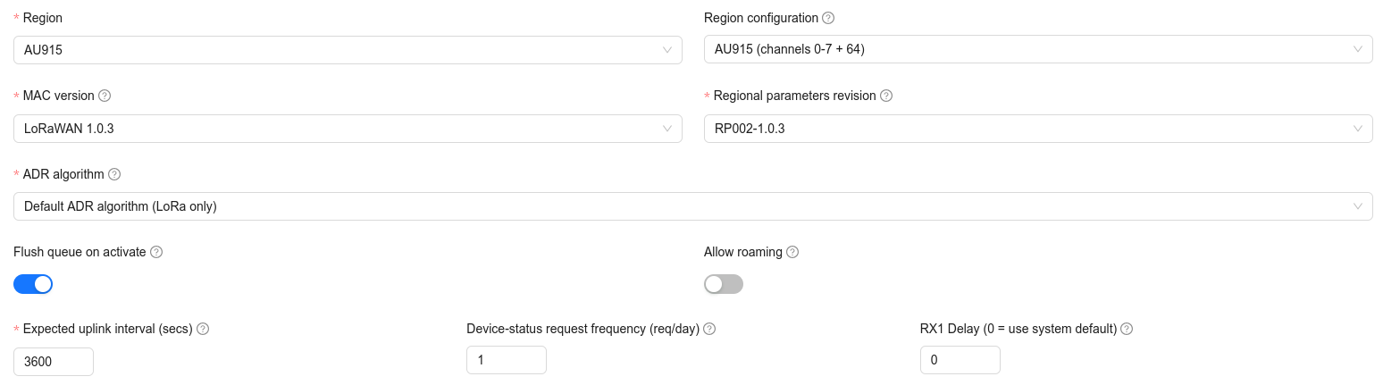

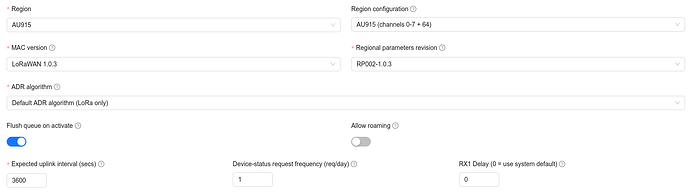

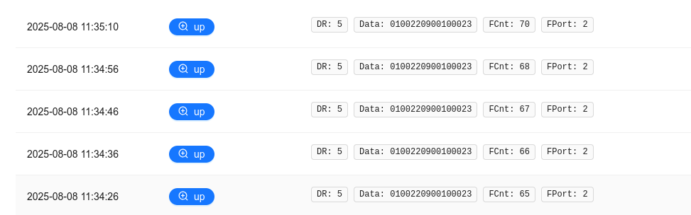

I’m attaching the serial monitor output and LNS screenshots.

[UPLINK] Start
[UPLINK] Sending packet # 68
[UPLINK] Send failed
+EVT:SEND_CONFIRMED_OK
[TX-CB] TX status 0
+EVT:LINKCHECK:0:11:1:-85:10
[LC_CB] Success Margin 11 GW# 1 RSSI-85 SNR 10
[RX-CB] RX, port 0, DR 8, RSSI -85, SNR 10
[UPLINK] Start
[UPLINK] Sending packet # 69
+EVT:SEND_CONFIRMED_FAILED(4)
+EVT:LINKCHECK:1:0:0:0:0
[LC_CB] Failed Margin 0 GW# 0 RSSI0 SNR 0
[TX-CB] TX status 0
+EVT:TX_DONE
+EVT:LINKCHECK:0:0:0:-77:11
[LC_CB] Success Margin 0 GW# 0 RSSI-77 SNR 11
[RX-CB] RX, port 0, DR 8, RSSI -77, SNR 11
[UPLINK] Start
[UPLINK] Sending packet # 70
[UPLINK] Packet enqueued, size 4
[UPLINK] Start
[UPLINK] Sending packet # 71
[UPLINK] Start
[UPLINK] Sending packet # 72

I need my system to work properly with confirmed uplinks. Since I’m using the example without changes, can you tell me if there is any special configuration that needs to be done in the LNS?
