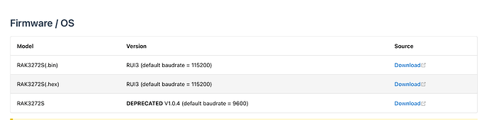

so the problem could be solved by updating firmware from legacy v1.0.4 to RUI3 4.0.5.
then the firmware downloaded from the website is stable enough?
