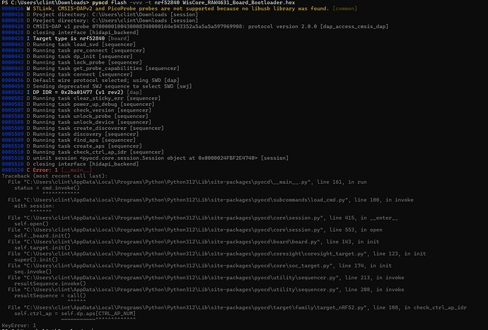

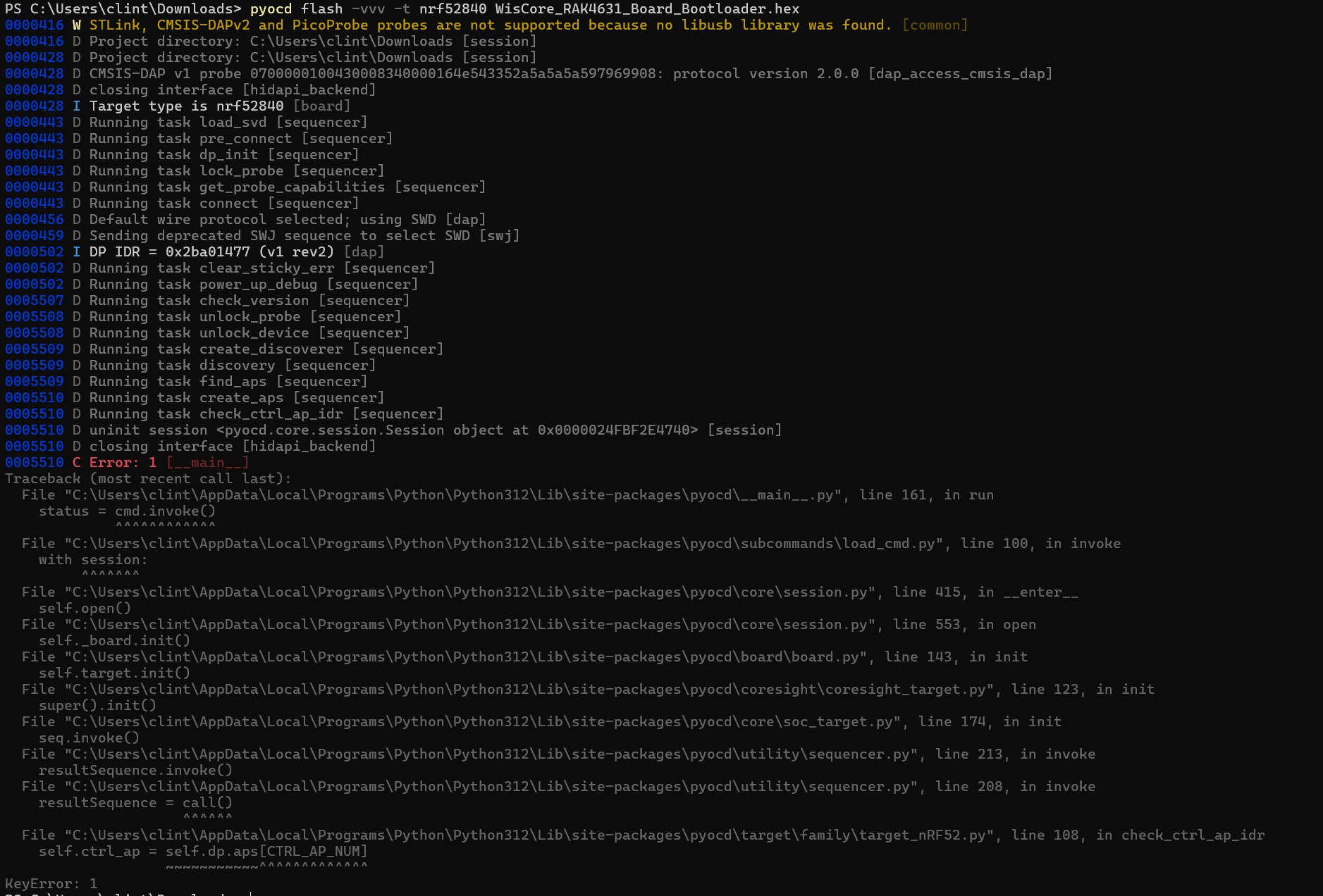

Still trying to flash but not working.
Current result:

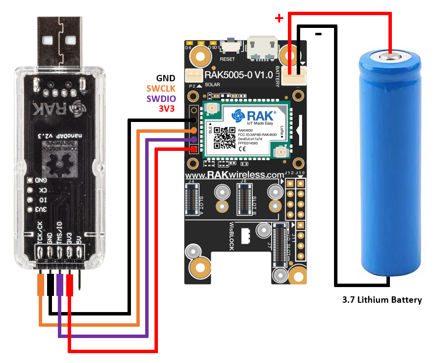

I am connected like this:
Your connections look correct.
The python error message is confusing and I have no idea what it means.
I am not sure what the real problem is.
