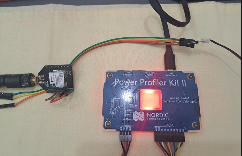

Minimum setup with RAK3172 Breakout Board
Measured with Nordic Power Profiler Kit II
Firmware RUI3-LowPower-Example
Setup to LoRa P2P, RX disabled.

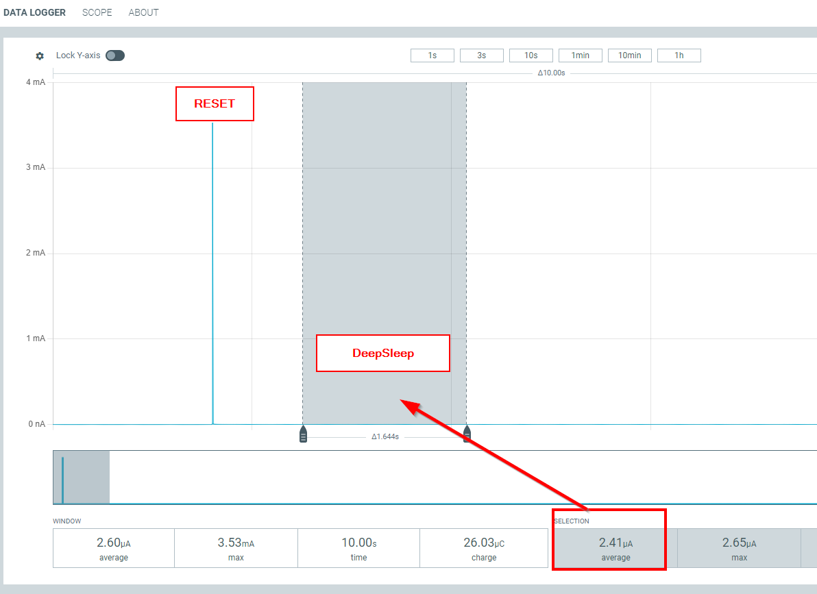

PPK2 output:
Hardware setup:
