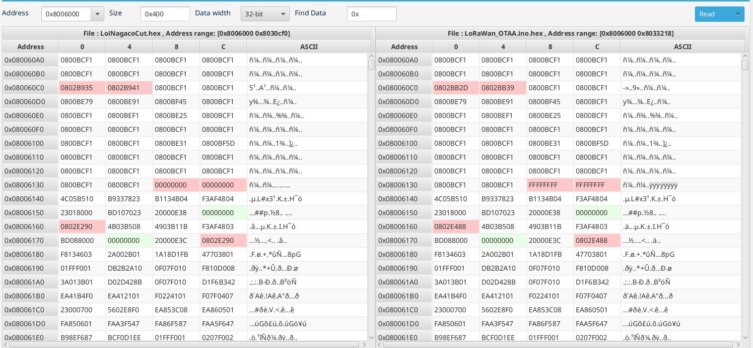

  1. I can read the corrupted file from address 0x8000000, but the Arduino rebuild file can only be read from address 0x8006000. So I compared from that address.
    The result is that some bytes are different at very random points. Some sections are completely wrong.
