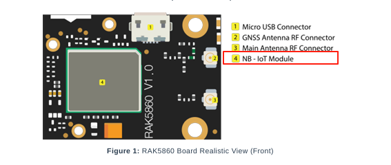

Thank you for the response.The problem I’m currently facing is that I can register to the NB network, but I cannot register to the CATM1 network. Therefore, I would like to know if your company’s module can be used for registration on the CATM1 network. I noticed that you are using the BG77 module, and the BG77 manual indicates that it supports CATM1. However, after practical implementation, I have become skeptical about this. Additionally, I found that in your RAK5860 datasheet block diagram, BG77 is labeled as the NB-IOT module, which also makes me doubt. I hope to receive your clarification.
Hello @SAYHELLO
yes, BG77 can register to CATM1 network. By default it is setup to try both: NB-IoT and CATM1.
The AT command to set the mode is:
`AT+QCFG=“iotopmode”,<mode>
where mode 0 is CATM1; 1 is for NB-IoT; 2 for both.
Note: make sure your SIM card / provider supports CATM1 in the region / country you are.
