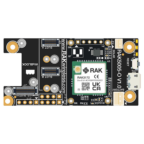

“AT+PSEND=313A4F4E”
and send again
“AT+PSEND=313A4F4E”
Send
AT_BUSY_ERROR
is coming back.
I checked how long I had to wait.
I have to wait 1000ms
“OK”
I did not return.
What are the specifications?
The LoRa air-time highly depends on the spreading factor (set by AT+DR). Maybe you can make the DR higher to have faster transmission. If your DR is 0, it can takes seconds to transmit the payload (specially if it is big).
As Carl mentioned, you have to select carefully spreading factor, bandwidth (called DR in LoRaWAN), coding rate, preample length.
With bad settings, the Semtech SX1261 Calculator Tool shows that even a payload of only 4 bytes can take several seconds to transmit, and that is only airtime without the overhead to send the packet.
