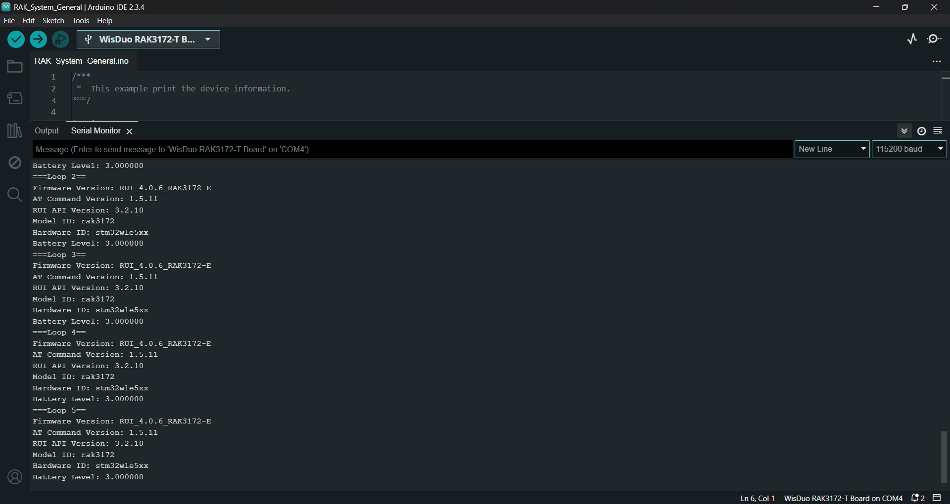

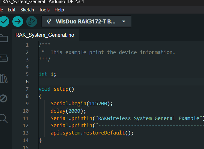

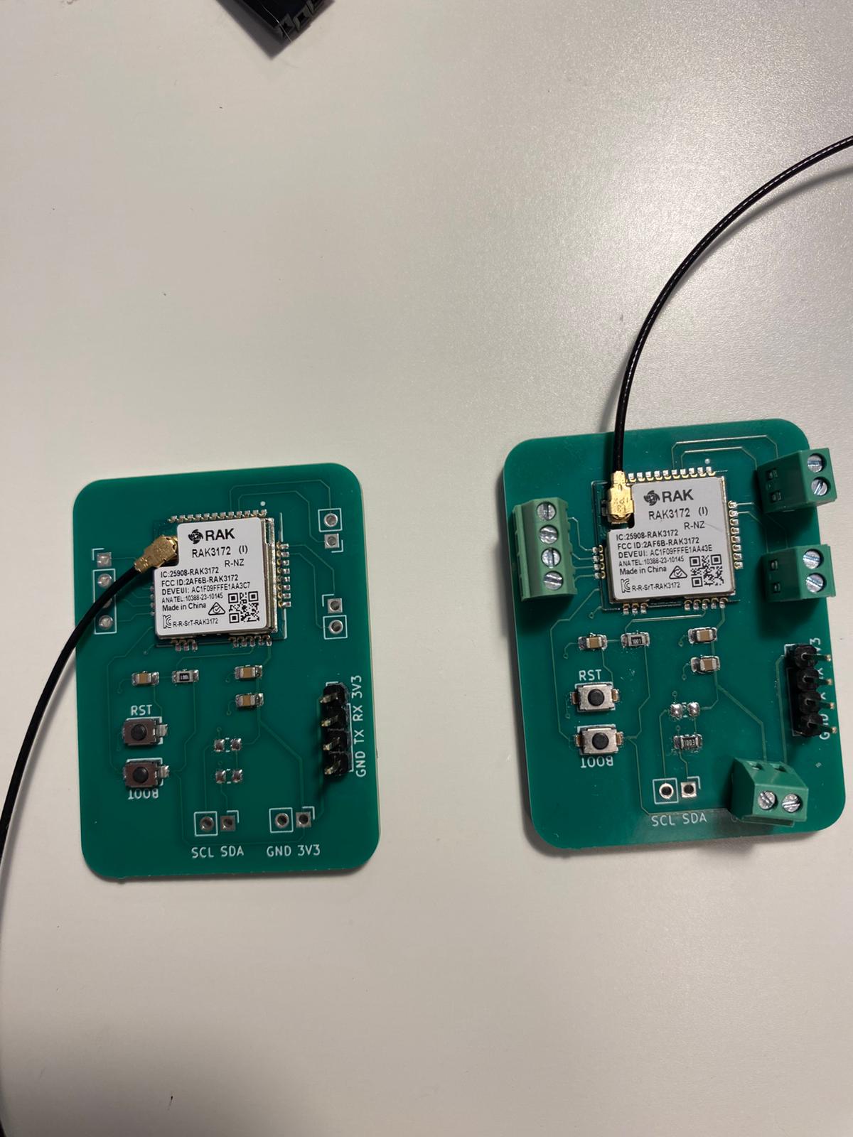

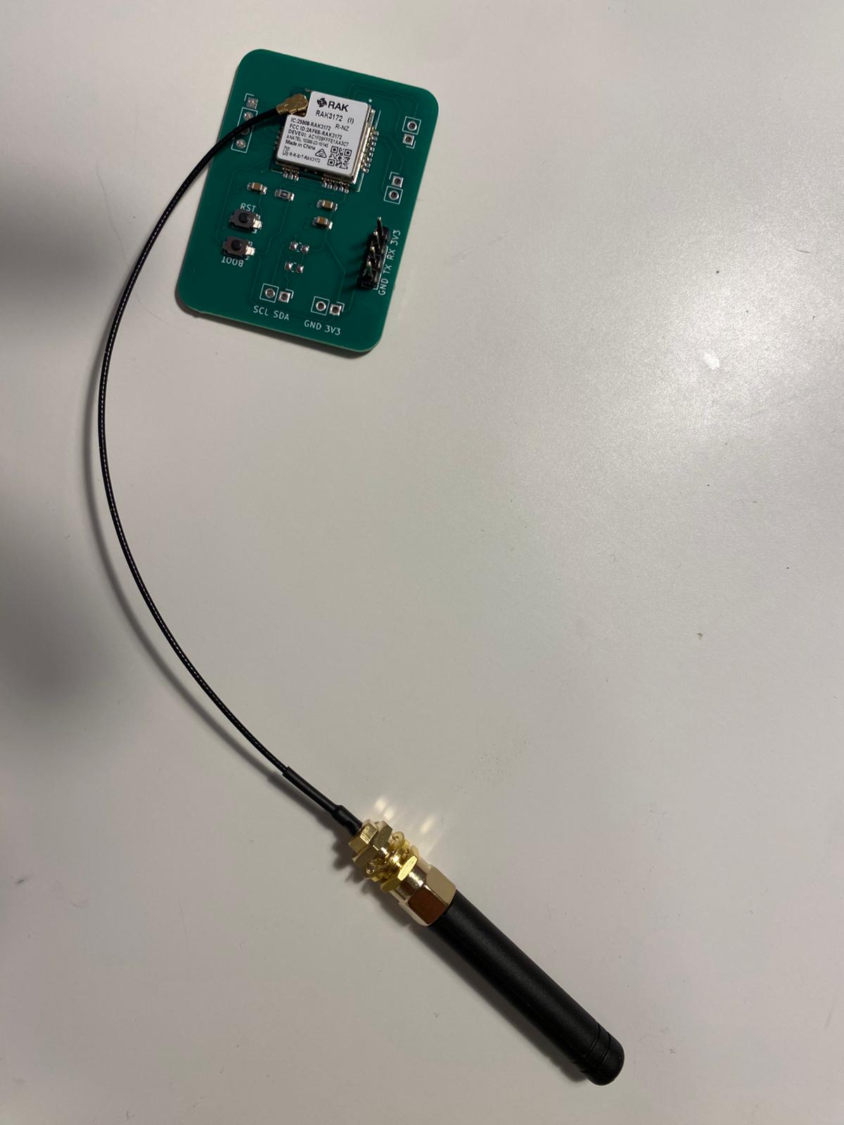

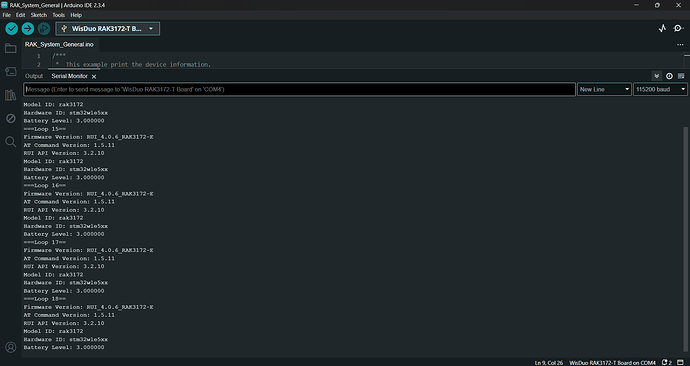

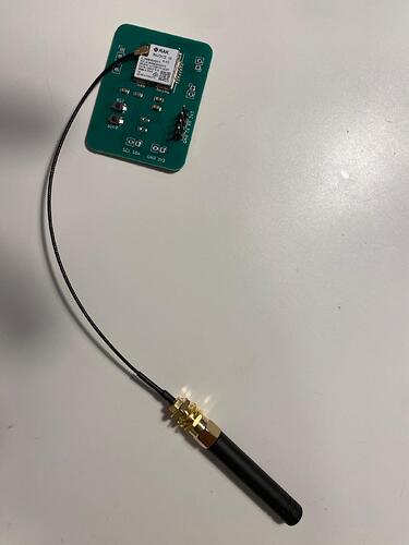

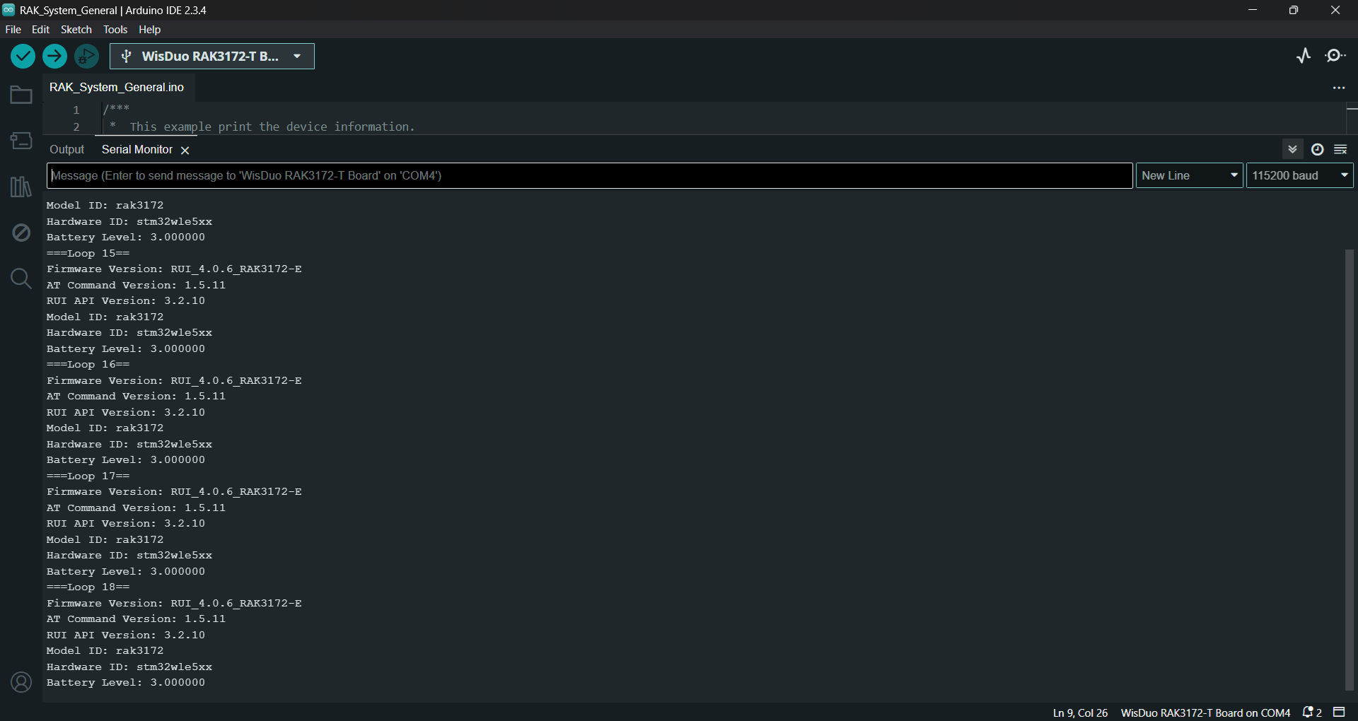

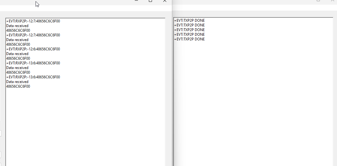

Using Following codes for TX and RX. Communication doesn’t seem to work.
If someone can suggest troubleshooting tips or snags in the code.
LoRa Freq is adjusted accordingly for Australia.
