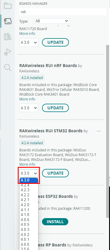

And the Arduino BSP’s are available for in Arduino IDE as well.
