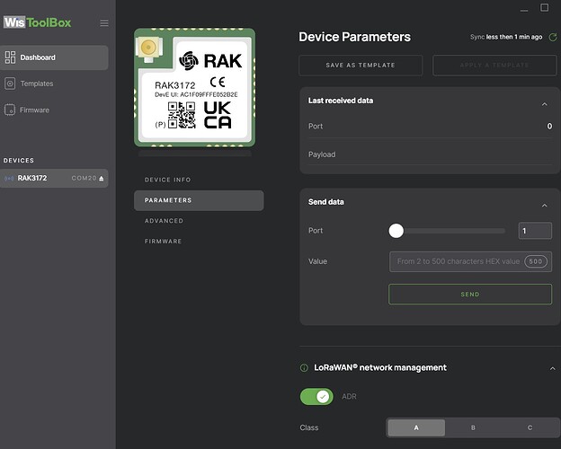

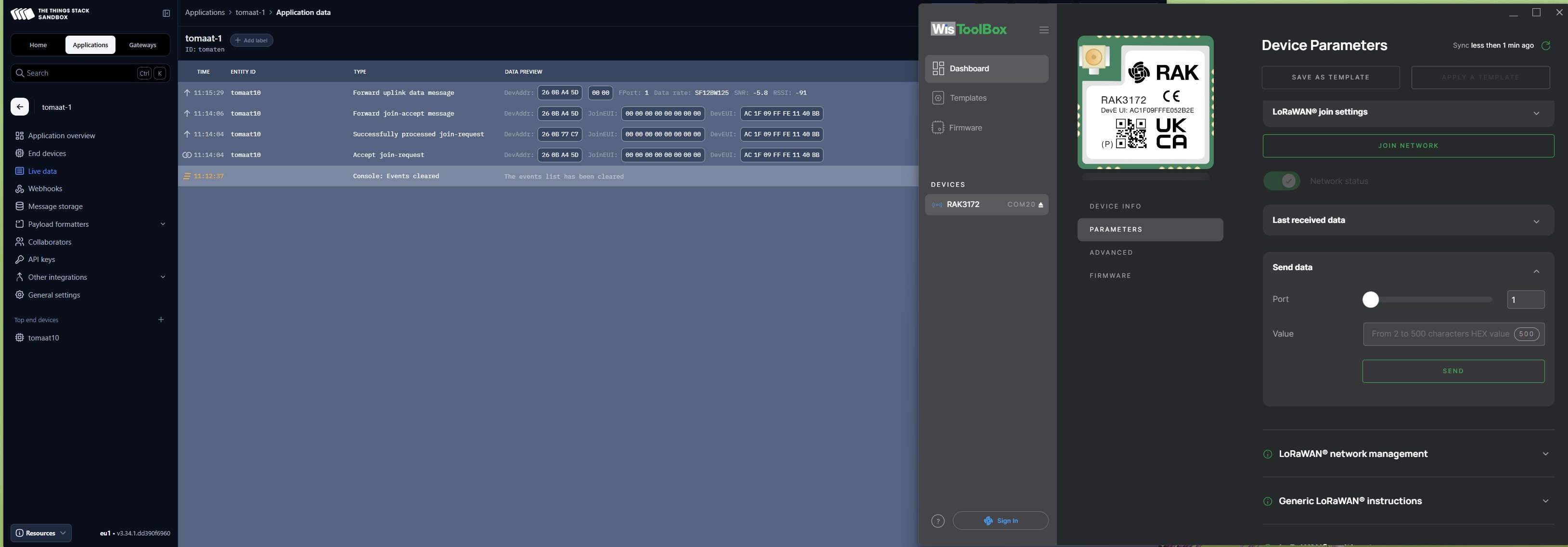

Hi Bernd,
I use the ttn sandbox look at the image

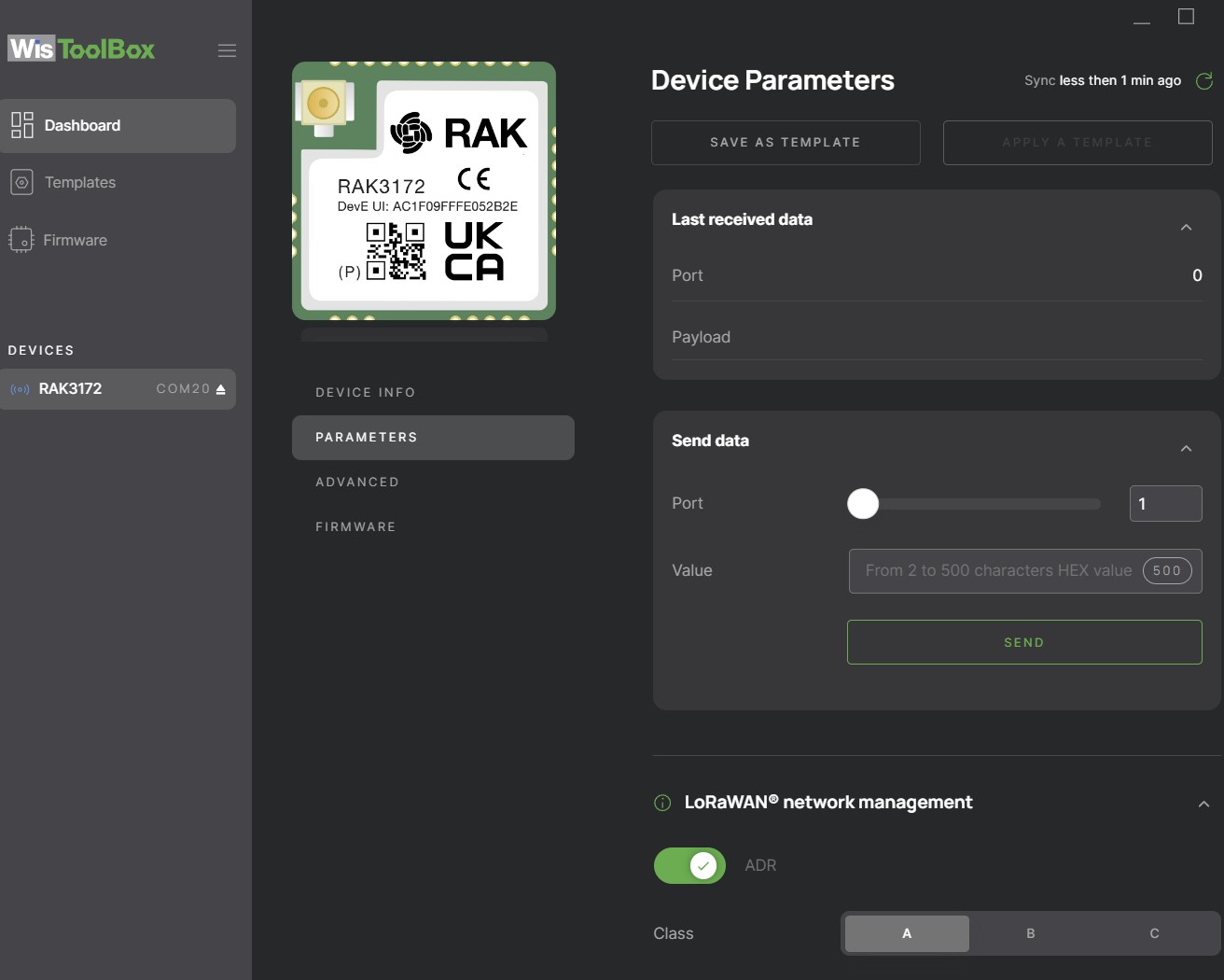

I type in the message see jpg.

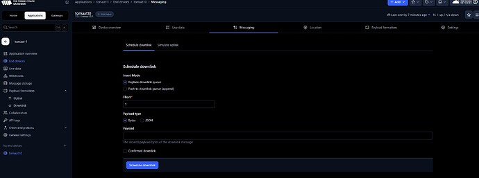

There is also a bug in wistoolbox: The receive port is set to 0. I cannot send to that port from the sandbox.
Only from port 1 (or higher)

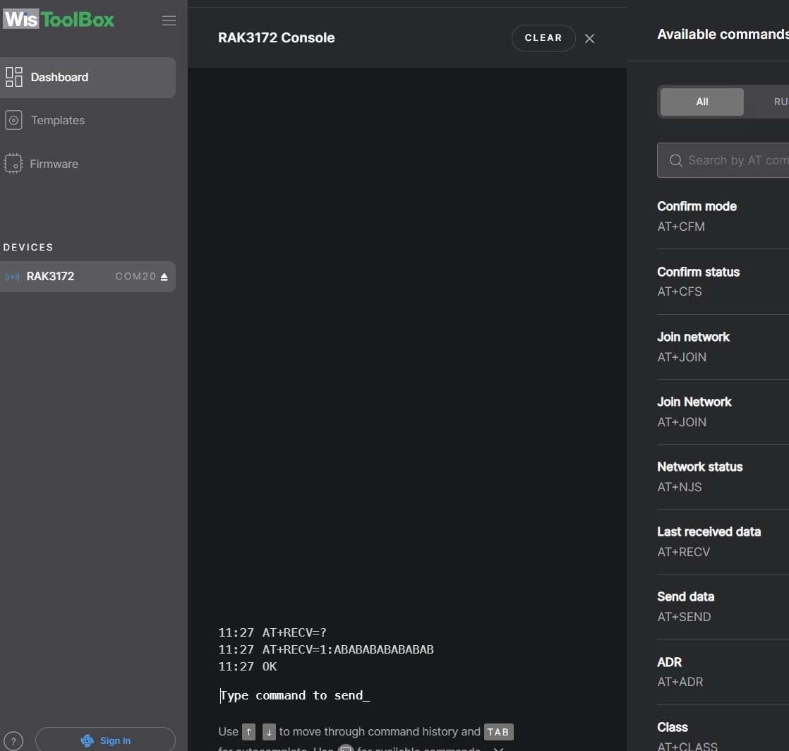

It does receive from port 1, but i can only see it in the console:

WisToolBox does not show uplinks. It is a tool to setup devices and test basic communication.
LoRaWAN allows ports starting from 0, it is not a bug in WisToolBox that it shows that port number. You have to set the port you want to use before sending a packet.
If you want to see confirmation, you will see them only in the WisToolBox console.

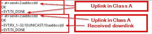

I am using a “normal” serial terminal app to communicate with my devices for testing.
AT+SEND=2:aabbccddeeff
will send over fPort 2 the payload aabbccddeeff
then you will see in the serial terminal the feedback for it
